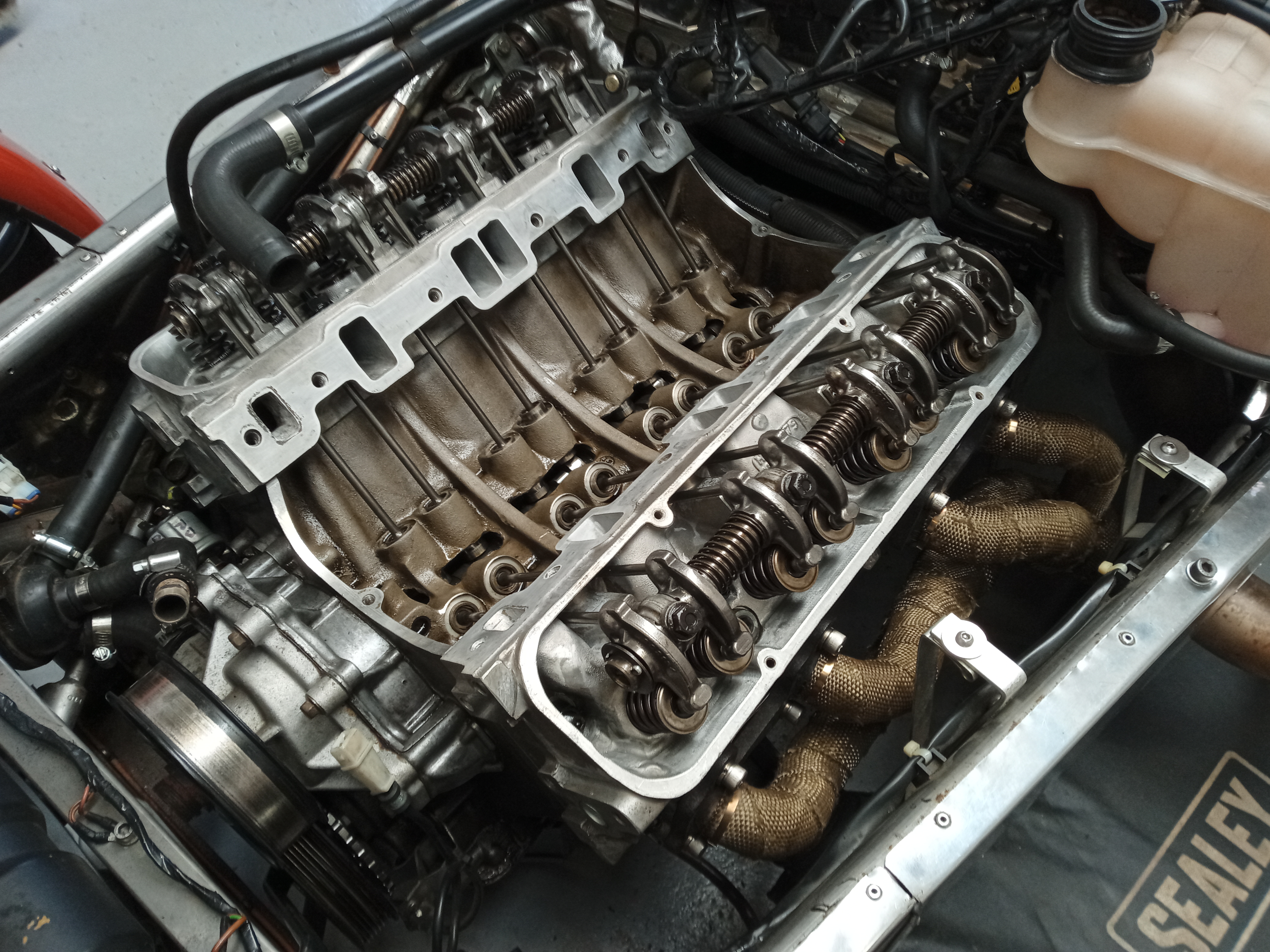

A somewhat overdue update here. I actually got the heads back from machining in October but due to other distractions, they were sat on a shelf for months before I got around to assembling them. No real issues putting everything together and here's an assembled head, looks just like a standard one. They have been skimmed but the hot tank left some water marks on the surface but it won't cause any problems.
I fitted the heads last week and while I had the engine it bits, I also fitted ARP head studs and steel rocker arms for added peace of mind.
I also fitted a new thermostat, just standard P38 because it's a fiddle to get to with the heads on and seemed like a good idea. Engine fired up fine and it does seem a bit more lively than before. My Emerald ECU is doing it's stuff with adaptive mapping but I need to get it on the rollers and set up properly to see what the actual numbers are compared to before.
