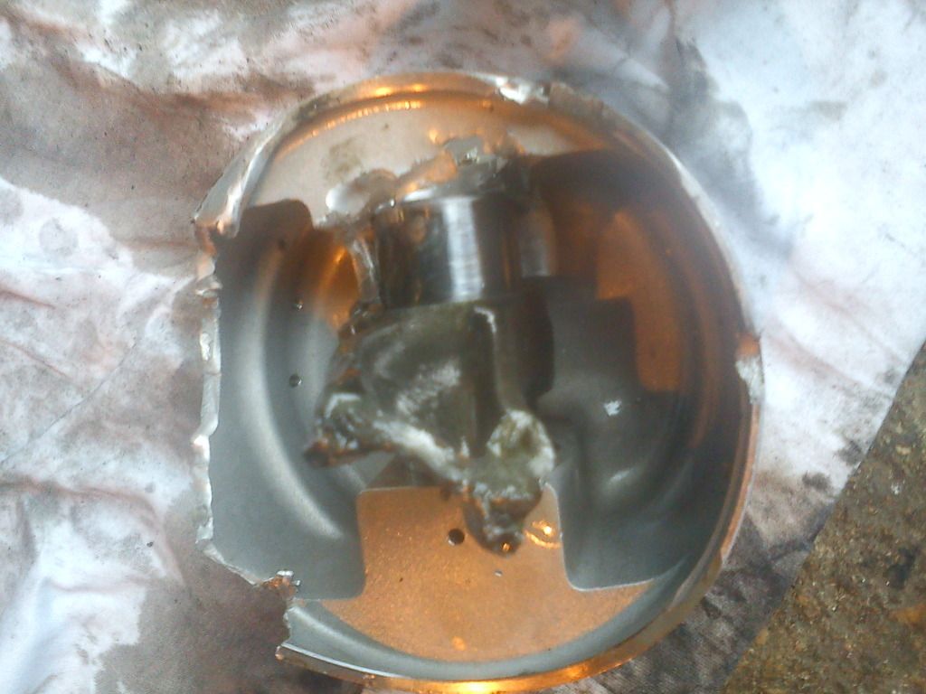

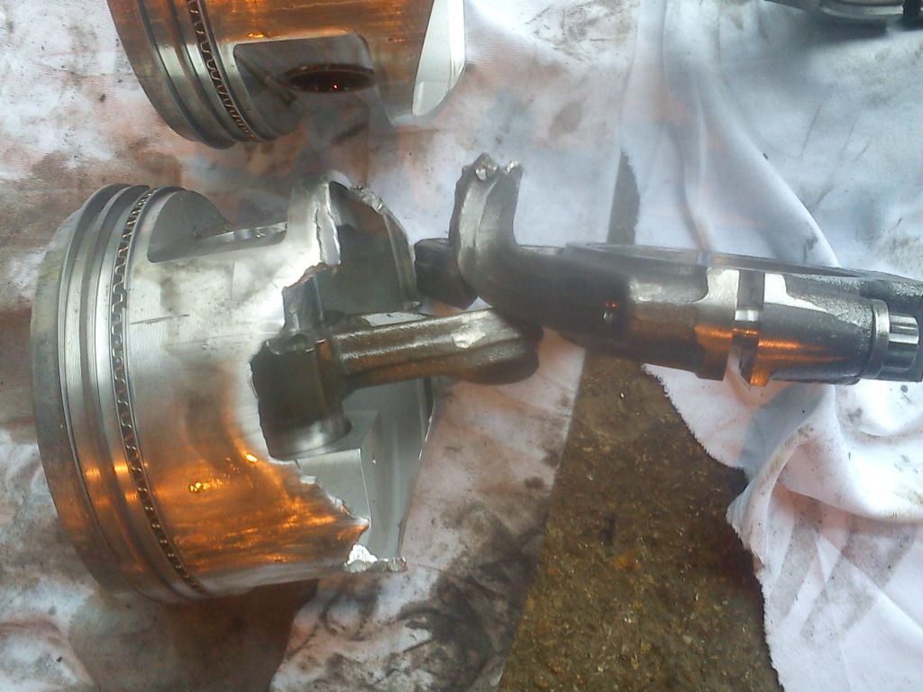

New block now fitted and ready for all the bits to be bolted on
ChrisJC wrote:I wonder if anybody has measured block flex at high power levels. Particularly >400BHP wot I bet Perry was running. Ultimately of course it will all bind up and catastrophically fail.........
Darkspeed wrote:I was talking this over with a very experienced rover man the other day and he said that at the higher RPM and power levels levels the block "pants" and a block strenthening kit is required (Girdle) - the 4 bolt mains are better but still not enough as the blocks flexe in between journals leading to failures - You need to lock it all togther.
The conversation on the block panting with Rovers came about when discussing the block strengthening kits on the little Hillman Imp engines which need a girdle when you start considering 8000 RPM+ due to block flexing.
Sorry for the little thread highjack there Pel and please do the leg work for us lazy sods and show us how to go about it all with an LS lump so we can break the Rover addiction.
