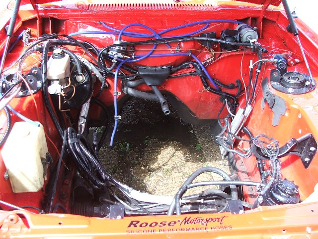

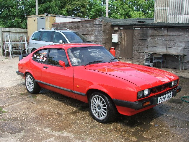

the car was collected and delivered to Caprisport today,
she will live there till done now,
looks a lot cleaner after a wash and the removal of nearly a years worth of dust and grime
OOOer a big hole that needs an engine,

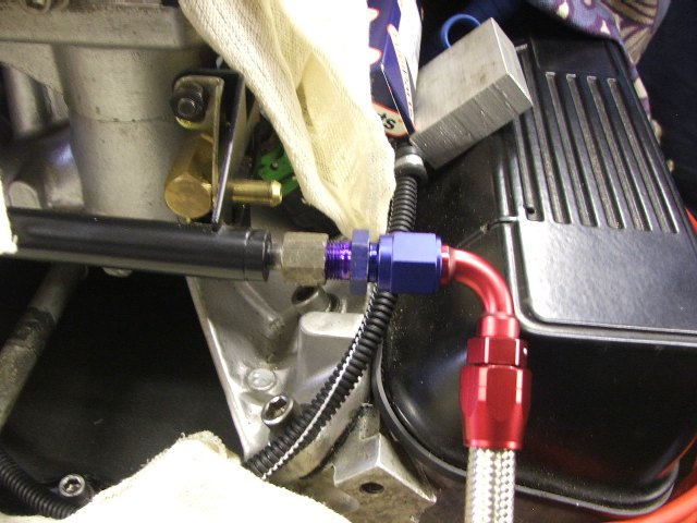

The hotwire fuel rail adaptor at last,
And adaptor -6 fuel line and swivel fitting,

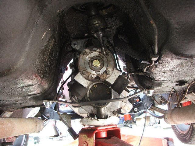

my 4 link rear axle brackets arrived today

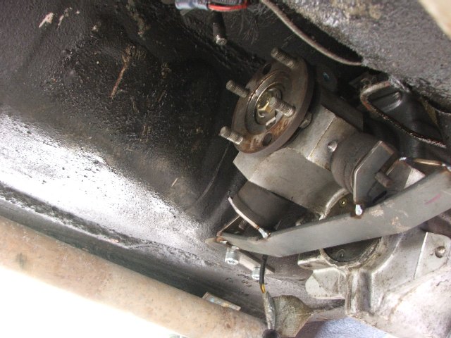

the dummy block fitted with mounts ready for making the new gearbox mount for the R380,
once the gearbox is located on its new mount, the new engine mounts will be made to drop the engine a bit more.
Start of the new R380 gearbox mount.
P.S, that the gearbox oil pump plate at the bottom of the rear of the box?
second shot,

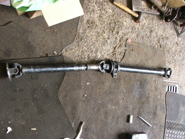

the prop rebuilt:
New axle brackets,
second shot,
the prop rebuilt:
New axle brackets,

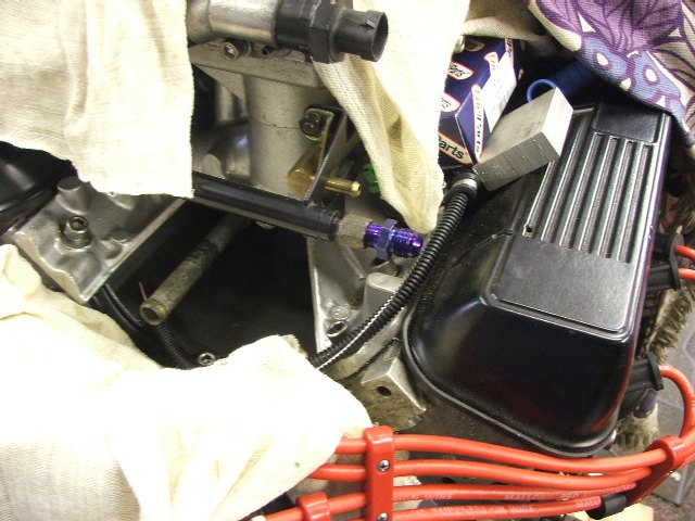

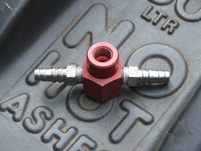

just spoke to Alex at torques and they do a 1/8npt x-6 adaptor,
so i can use the original fuel take off for the nitrous now with the -6hose in stead of the hose barbs as below

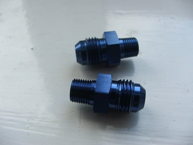

As always a quick turn around from Alex at www.Torques.co.uk
the fittings for the nitrous fuel take off arrived today

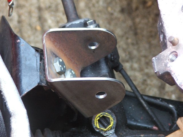

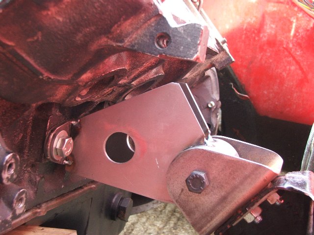

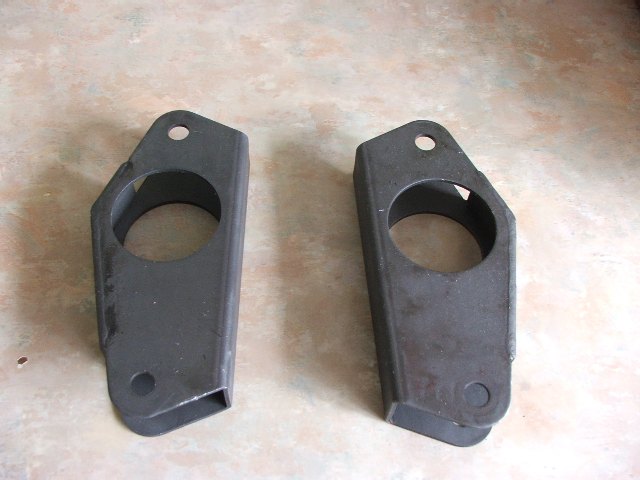

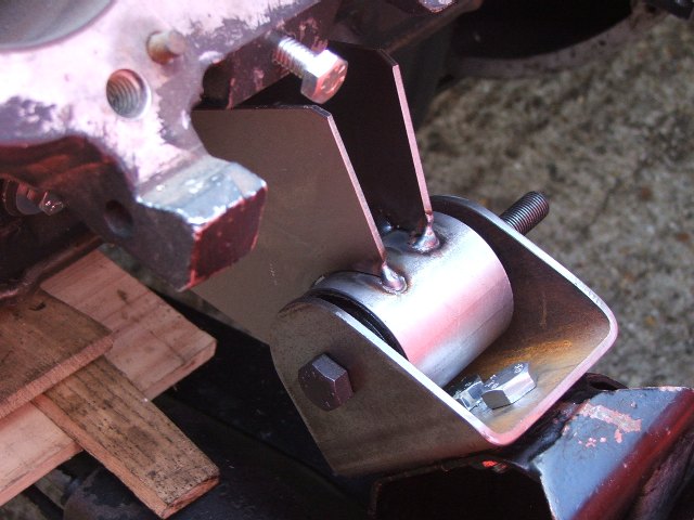

Well today was engine mount day
The following are the stage at we have finished tonight
Chassis mount bracket,
Bracket nearly complete,
second shot of bracket (please note the top support bracket from block not fitted yet)
these are going to be a 100% stronger than the old rubber bobbin style mounts the capris use,
SO hopefully i wont break these little babies
the tunnel has to be cut out tomorrow now, as Neil and Jon at Caprisport are not happy with the gearbox clearance

cheers guys,
need to remove the interior tomorrow as need to cut the tunnel again to lift the box a bit more, its defo sitting lower than we want after lowering the engine a bit more,

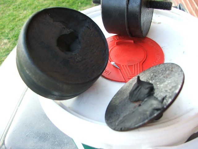

oh and the reason for the new style engine mounts,
broken engine bobbin mount classicford day at the pod 2007,
engine jumped that violent when it broke on the track it dented the bonnet
still ran a 13.5 though with one engine mount
