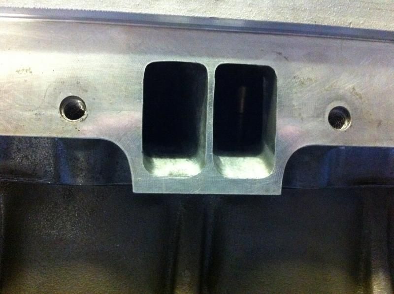

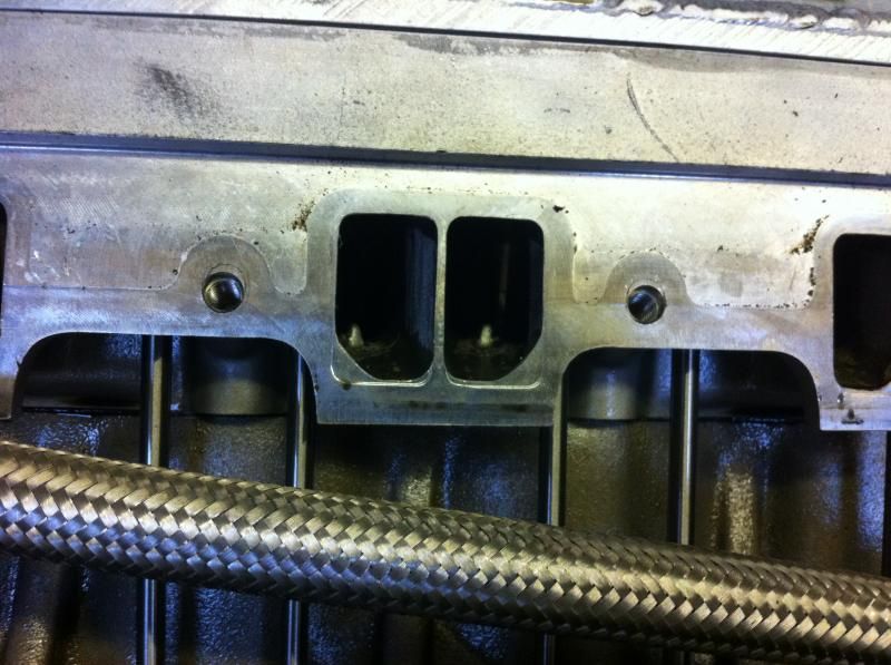

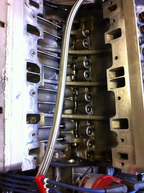

I have decided to do away with my Edelbrock 500 carb and fit EFI with Jenvey throttlebodies. As I have never been happy with the shape of the inlet ports I have decided to port match the heads to my new inlet manifolds.
So I have had the heads off and removed those stupid corner infills but for the time being the Huffaker/Edelbrock is back on until I am ready to fit the EFI.
Pics of standard v modified ports.
Will be interesting to see if there is an improvement.

Do you still have that weird fin in the intake port floor ?

Hi Jukka
No I removed that too and smoothed and blended everything.
Don't you think they might have been put there for a reason? :?

Post by mgbloke »
Probably but with the downdraught manifold the injector is pointing straight at that step in the corner which cant be right. So have port matched the manifolds to the heads.
Time will tell.

Post by mgbloke »
Sureley those corners can only restrict flow at the top end? I can see they could be a benefit lower down the rev range.
