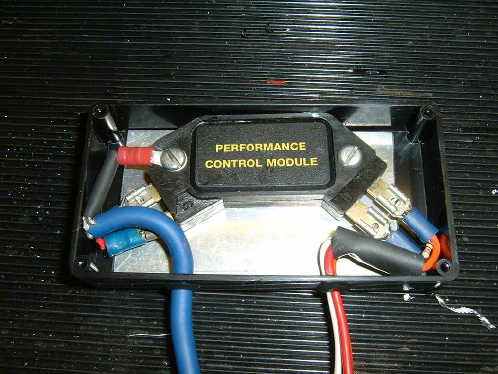

The electronics engineer in me says you should either twist the two wires comming from the Dizzy to the Ignition module together or use screened cable. I used this when extending the wiring to one of those modules:
moduleshttp://www.maplin.co.uk/Module.aspx?ModuleNo=133
Picture:
http://www.mez.co.uk/dcam/DSCF0328.JPG
You only earth the screen at one end.

Eliot wrote:The electronics engineer in me says you should either twist the two wires comming from the Dizzy to the Ignition module together or use screened cable. I used this when extending the wiring to one of those modules:
Picture:
Hi Eliot, Would you please explain why you recommend twisting wires or screened cable for idots like me who haven't a clue when it comes to electronics! Also what is the little resistor for on the other wires?
Its to prevent Interference or/noise from the HT side effecting the signal coming from the VR sensor.
