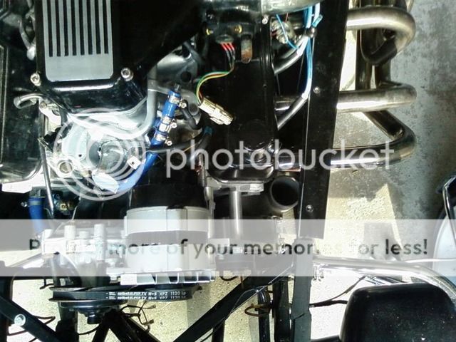

Supercharged (nearly turbo) 3.5 V8, no dizy, using 2x ford coil packs, trigger wheel bolted to range rover front pulley, megasquirt does the rest, fires the coil packs and controls the ignition/ fuel .Dont think i have seen another rover v8 engine with twin turbo's and EFI. Is there any out there??
I just cut the dizy in half with a hacksaw just above the step where the clamp secures it. With no dizy all it's doing is transfering the drive from the end of the CAM to the oil pump. Once the dizy is in bits it's easy to see where it would need to be cut.

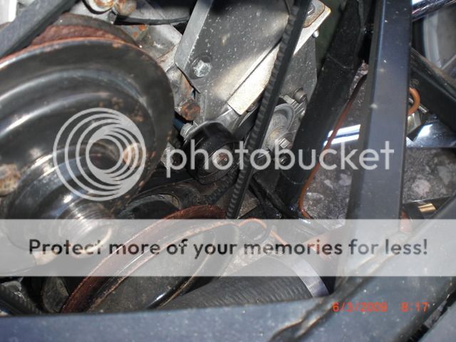

I never had it rolling roaded, so don't know HP. I did a 12.9 @ 103 1/4. I was a fair bit quicker than a 200bhp N/A cosworth Dax Rush at the same event. It felt noticably quicker with the supercharger even though I was only getting 3psi during WOT. lots of belt slip with the v-belt.
It's quite a tight fit down there!

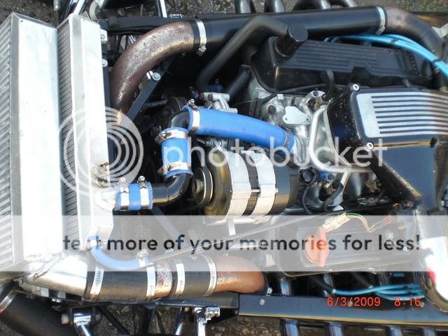

Well i will still be running the twin turbo's. Here is a couple of pictures of a guy who i am in contact with. Colour not my tast but engine is. Ideally tho by running EFi etc i can go for a look that will hopefully look more like it was originally in the car. Going to change the red block to black also with just black silicone hoses and some big pipes running around. Im one for keeping things fairly stock looking just with added goodness and slight modernisation when it comes to the bodywork.
