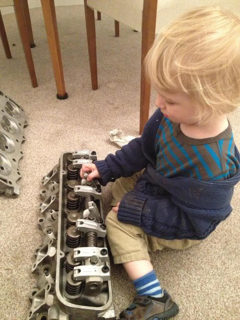

[imghttp://i1064.photobucket.com/albums/u366/daviesdj/Mobile%20Uploads/image-27.jpg[/img]
Just about ready to put the heads back on- my son Arthur giving me a hand (only 2 but never too young!)

Catch them young and you have them for life!
Hi DJ
job for next week, go to a scrapyard, buy a Honda C70 engine and take it apart with the help of son, you can never start working on engines too young :D and a v8 is a bit complicated when you are under five . :lol:

Hope the lad doesn't get into trouble for working on the dining room carpet. :lol:

The wife is away in Germany this week! So it's parts in the dish washer and assembly in the nice warm dining room. Landy owners used to say...
