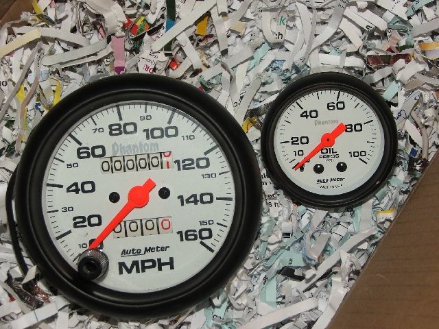

while ecu has been away i have been starting to get some bits ready for the cars face lift inside,
thing is they aint cheap
autometer phantom, reason i went for these as the capri had a white dial kit,
and these look as close to stockish as we could, plus they look better
just the rest to find now, if any one spots any cheap gauges like above let me know please,

I have oil pressure, temperature and boost gauges in the style you want. They're sitting around not really doing anything.
