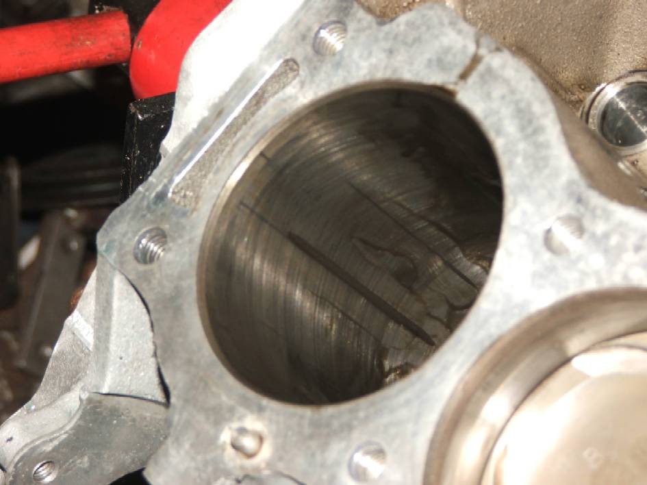

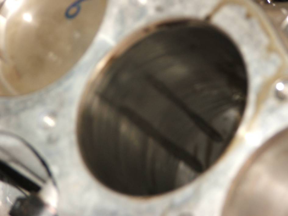

Shite pic of the bores,
another shite pic of the fooked bores,

pistons seem fine,
pins shagged, and it looks like the pin end also shagged on rods,
im thinking about getting another set of 4.0 pistons and getting the reliefs cut proper this time,

RV8 pistons don't have circlips as the pin is a tight interference fit in the rod end. In the case of Tony's rods the interference fit was inadequate and the pins drifted off centre and damaged the bore. Who knows what the history of these rod is but all 8 will need chucking to ensure a non repeat of the problem. Maybe the rod end has cracked due to overheating and sudden cooling during pin installation but I am guessing here.Ian Anderson wrote:Were there not circlips in the pistons to stop that happening?
Cheers Denis
