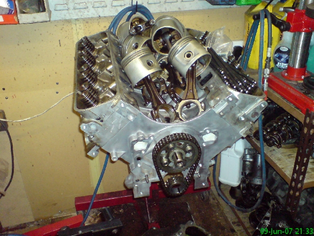

New engine
well only just got the car to the track and on the road proper, and im already starting to work out building the spare engine,
its a 3.9 a very tidy engine, the bores are good too,
now what shall i do with it?

That engine, forged pistons, higher c/r and ALOT of nos! Trev ran a 3.5 with an 11:1 c/r plus that infamous 700hp nos shot. You'll be showing Stevie the way down the track with that much poke!

ihatesissycars wrote:Trev ran a 3.5 with an 11:1 c/r plus that infamous 700hp nos shot.
:shock: :shock: :shock: :shock: :shock: :shock: :shock: :shock: :shock: :shock: :shock: :shock: :shock: :shock: :shock: :shock: :shock: . 700hp of nitrous, How long did the engine last or was it just one run. If so, what time did he run or was it else where just to see what happened ??? :?
Was Rover v8 10.7@122mph, 0-60-3.01sec
Now Blown BigBlock Chevy 9.9@134 upto now on low boost.
