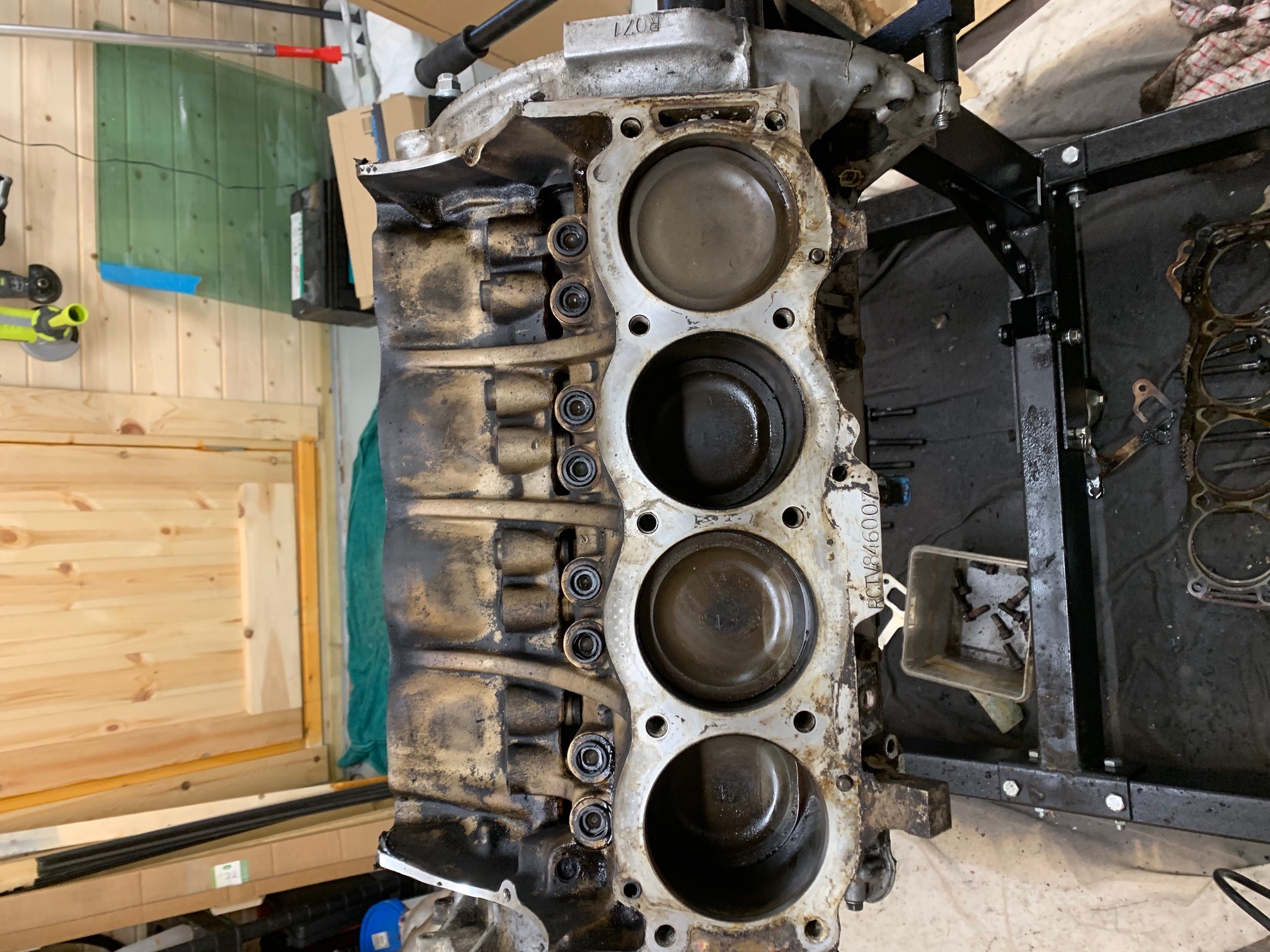

I am having my Rover V8 4.6 rebuilt and would like to try to identify the engine number. The engine was out of a RR P38 1997 but the engine number is RCTV846007.
Does anyone know where and when this engine was produced or whether is was remanufactured? I have attached a photo if that helps.
Any light that can be shed on this would be greatly appreciated.
Many thanks.

Post by garrycol »

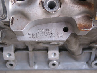

That is not the original stamping so probably not the original number. When the blocks were stamped when being made it would have been in a "dot matrix" style and have the compression ratio stamped as well - it looks as if the number you have has been manually stamped possibly after the top of the block being shaved.
If original it should look something like this
Jackrancher
Posts: 3
Joined: Wed Mar 30, 2022 3:56 pm
Re: Rover V8 Engine Numbers Updated:
Post by Jackrancher »
Thanks Garrycol for the info :D
Does anyone know who would have performed this work? I am thinking that having restamped the engine that it must have been an engine rebuilder or reconditioner somewhere...........
