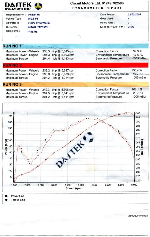

Its a DASTEK and was new in 07. My last visit was 22/02/08 when the maximum power at wheels was 242.3bhp@5306rpm, at flywheel 292.5 bhp@5841rpm and torque 294 lbft @ 4244rpm.

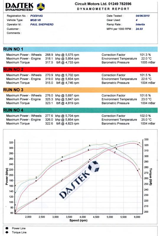

Anyway Results are VERY good, much better than I expected. I have dropped the dyno sheet in to a friend to scan them so will post later.
The first run Showed power @ 318bhp which I was very pleased with.
Then they optimised the timing which as it turned out was slightly too advanced.
Final run 326bhp and 322 lbft torque.
I was hoping for around 310bhp so I am very pleased in deed.
My power to weight ratio is now 336bhp per tonne. Cant wait to get it on track.
Of course The new exhaust must have helped the power figures but I am still glad I chose to go down the Merlin Head route.
The heads are totally standard with the exception of removing casting flash and small imperfections to the runners.
Thanks to everyone for their advice.
Mark

Here it is.

Just found my Old dyno sheet from 2008 for comparison.
mgbloke
Posts: 526
Joined: Thu May 17, 2007 6:05 pm
Post by mgbloke »
OOPS wrong one try this
I would say a 35 BHP improvment on a rover for a pair of heads is somthing to be very pleased with, especially when it is achieved with a smoother torque curve You should be well chuffed with that.

Mark,
Excellent result and only 10 BHP less than the Real Steel 5 litre engine, considering you are conceding 450cc your engine is producing more BHP per litre than theirs, well done.
Kevin.

Post by mgbloke »
Looks like the extra 450cc has a greater effect to torque than bhp.
RS 5.0 has a very flat torque curve helped by the longer stroke.
My 4,6 is very happy to rev way past 6krpm so now need to think about rocker shaft end supports as mentioned.
Very happy with the results.
