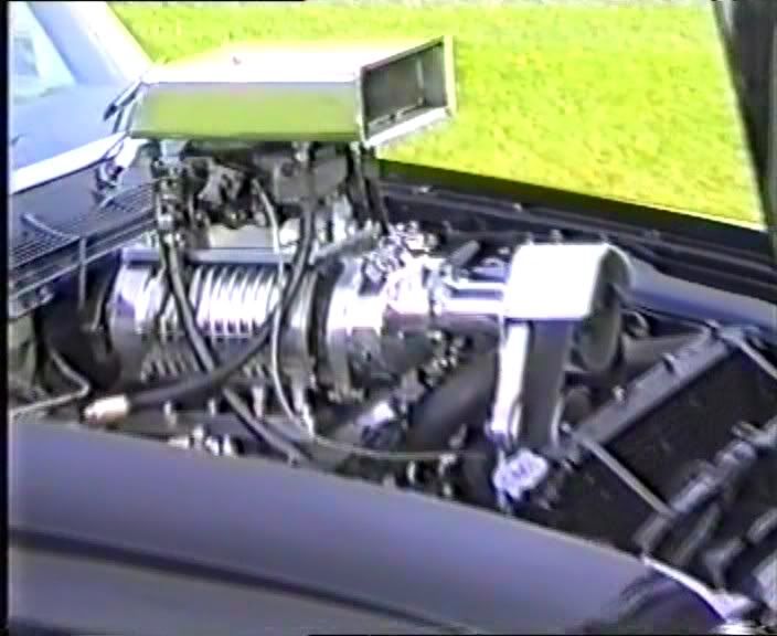

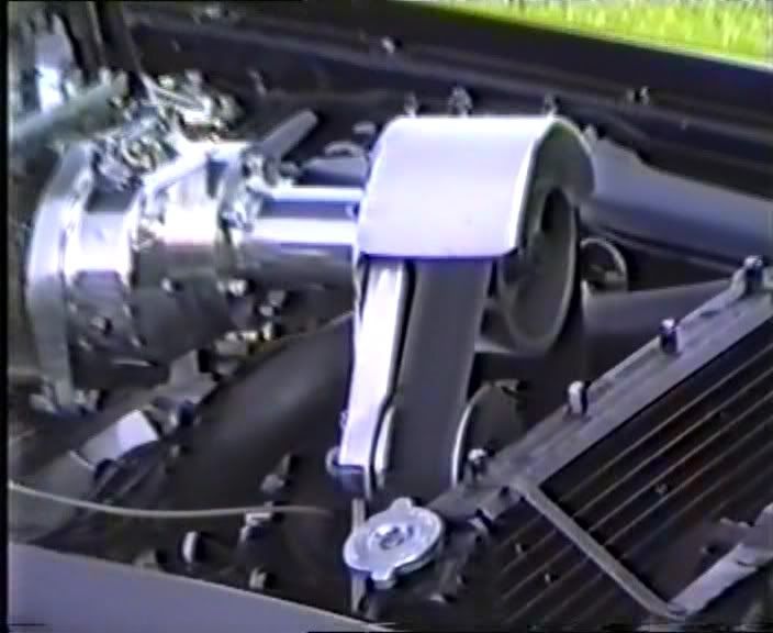

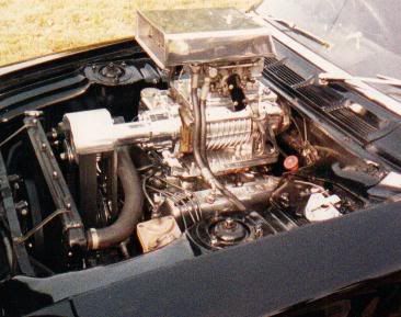

Mark
Posts: 383
Post by Mark »
stagcar wrote:Thanks Chaps for all the good info
I alos need to make up a tensionor but i have the pullys so shouldend be to much of a problem
Has any one got any pics of a wade blower fitted to a rover v8? i would be nice to have a look at the belt tensionor and position
Many thanks
Derek
PS i will try and mock it all up this weekend if by bird will let me near it! :shock:
I screen grabbed these from an old home movie so forgive the quality !
Car is long gone now, also this is a scan from an old photo.
May be of some help ?
regards
Mark

That looks very nice mate
it looks like most of the tenshioners ar mounted on a clap arangement around the blowers snout
I may well do somthing similar then
Thanks for posting up the pic's looks the muts nuts
What car was it?
Derek
