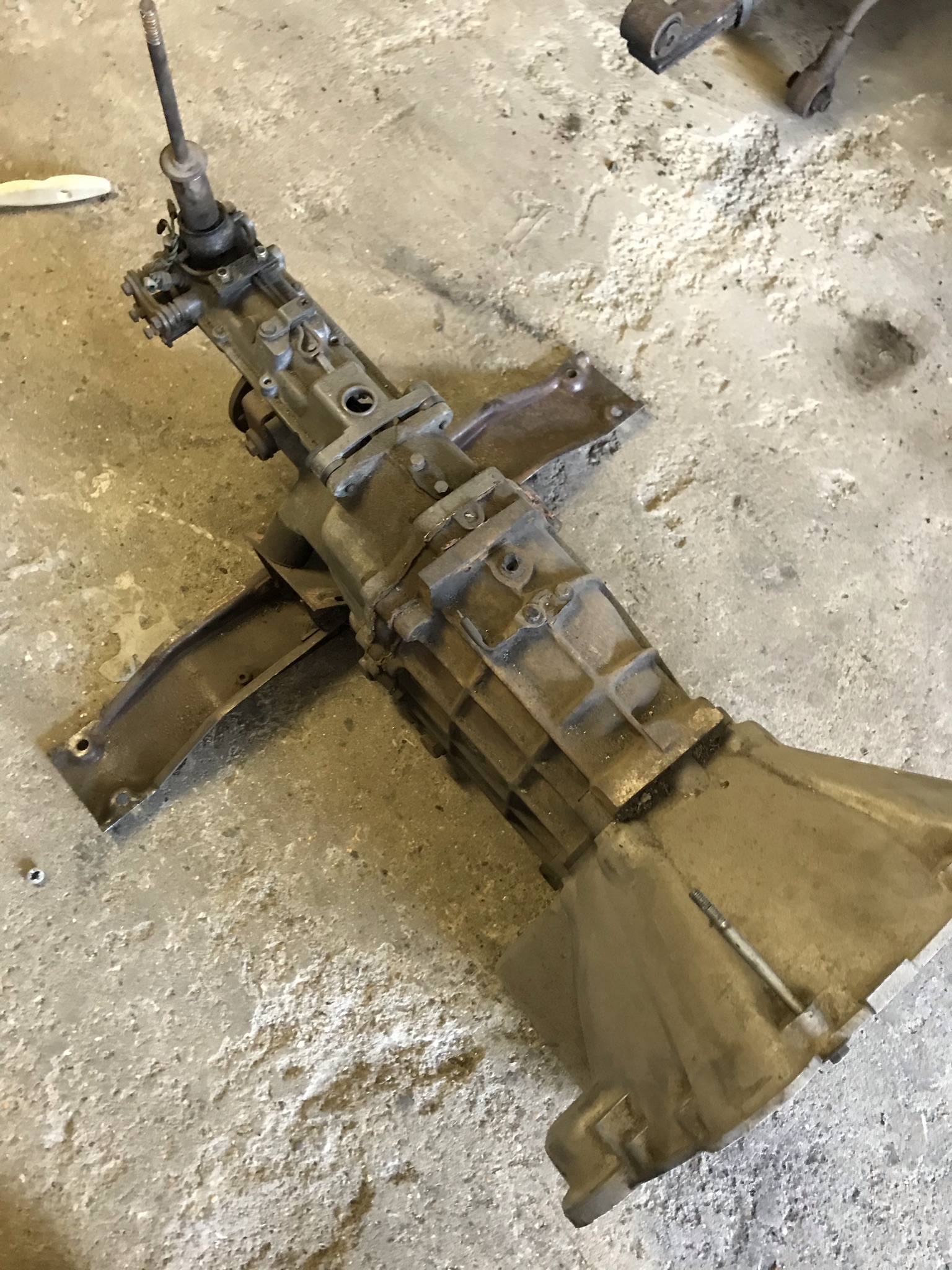

I have what I believe to be an LT77 gearbox. I'm having similar issues identifying what it's from. There isn't the typical serial number i was expecting, instead it has these engraved figures on the bottom of the casting. 19A22531A

That’s not where the number is found in my experience, it’s normally on a flat machined, oval-ish, area on the side of the main casing (right hand I think)joshls wrote: Sun May 02, 2021 6:51 pm Hi,

The oval pad on the side of the main casing with the serial number stamped on it is only on suffix C boxes onwards. Suffix A and B have the number stamped underneath.
Suffix A and B have smaller bearings on the first motion shaft so not as robust as the later boxes. Even a good one (if you can find one) is probably marginal behind a standard V8. Generally once the first motion shaft bearing go, the box is scrap.
19A22531A would be very early SD1 V8, I've rebuilt quite a few LT77s and I generally avoid anything pre-suffix C because some of the earlier parts aren't available and I've not found on yet that was worth rebuilding.

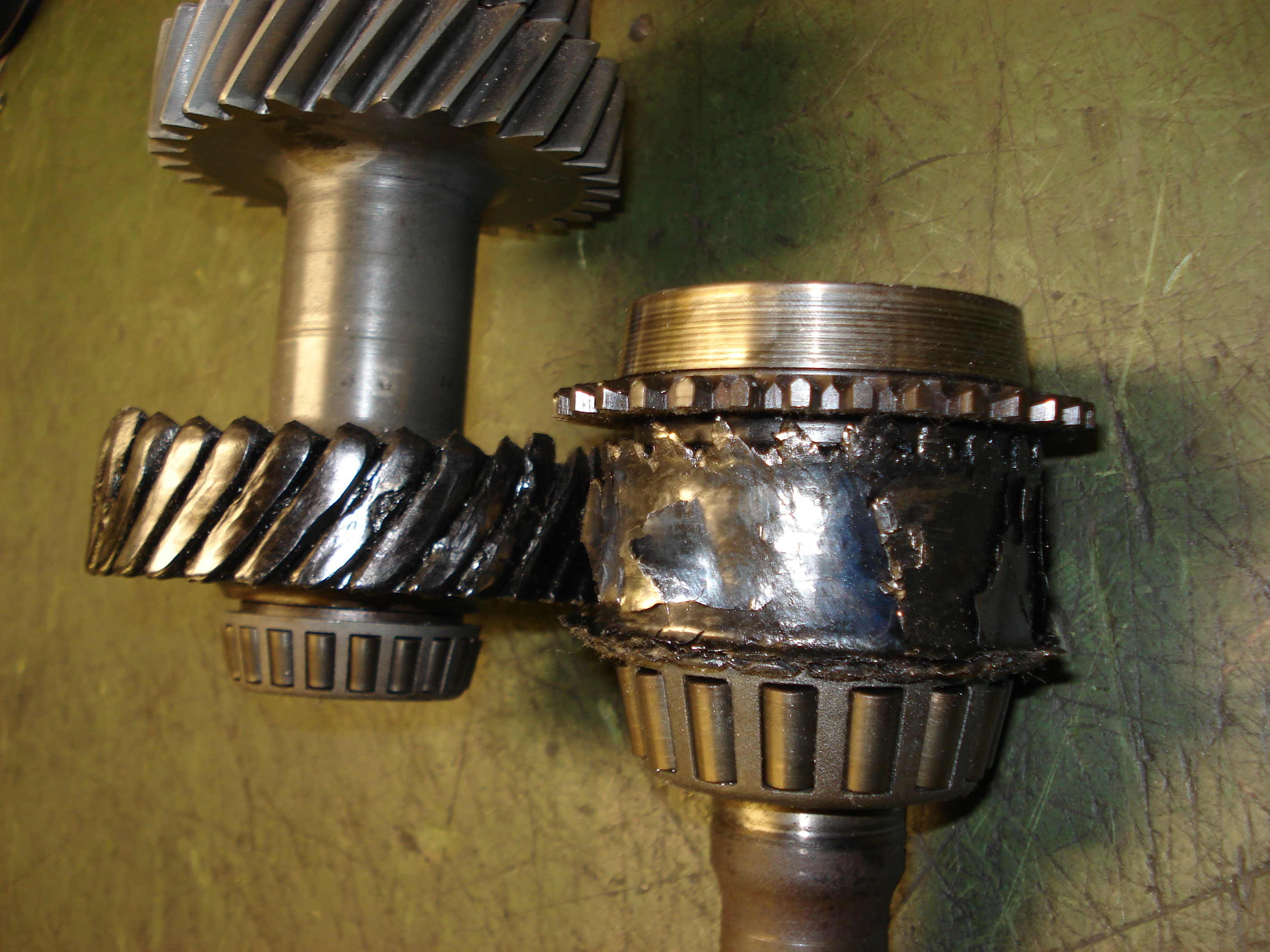

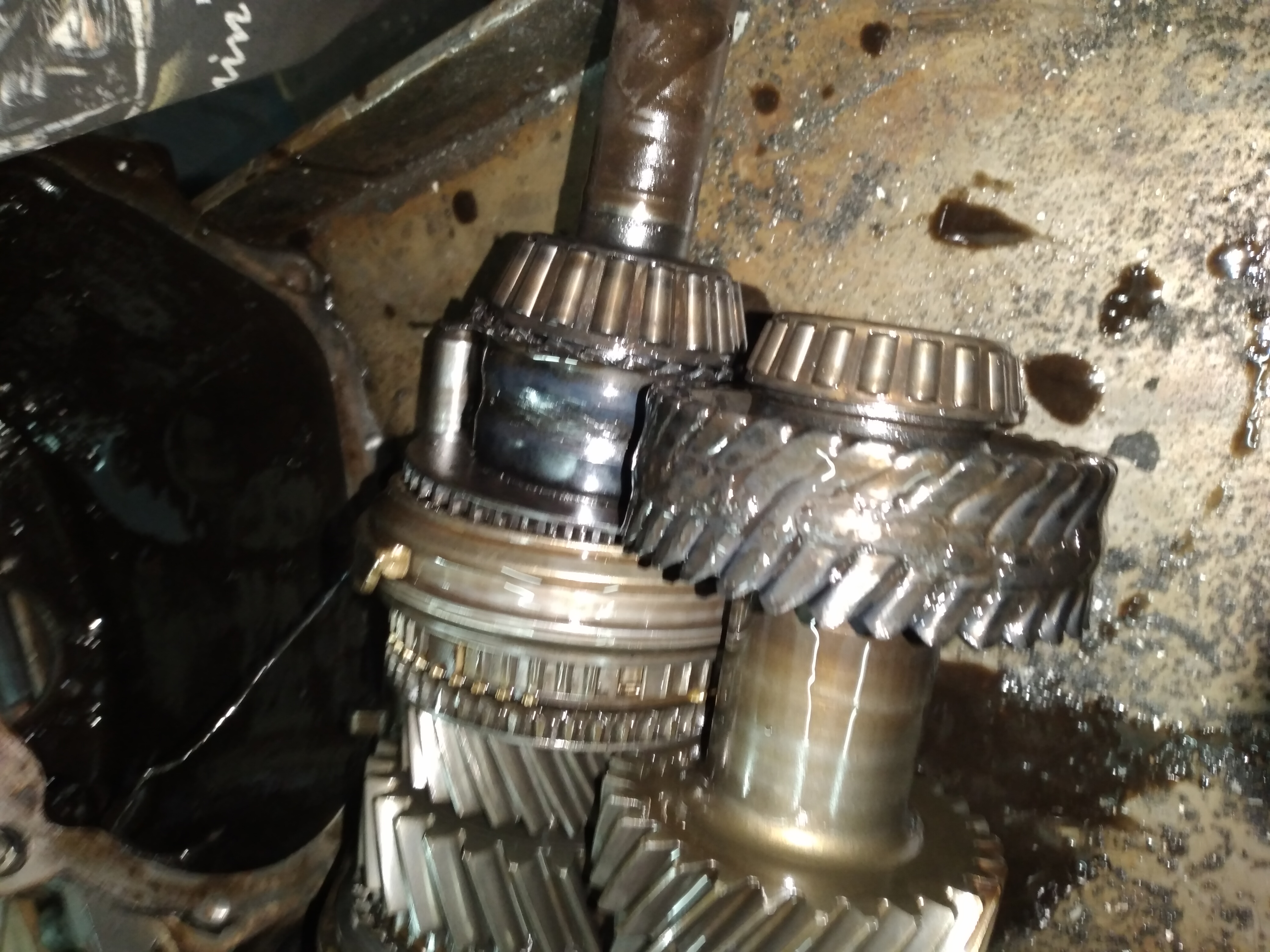

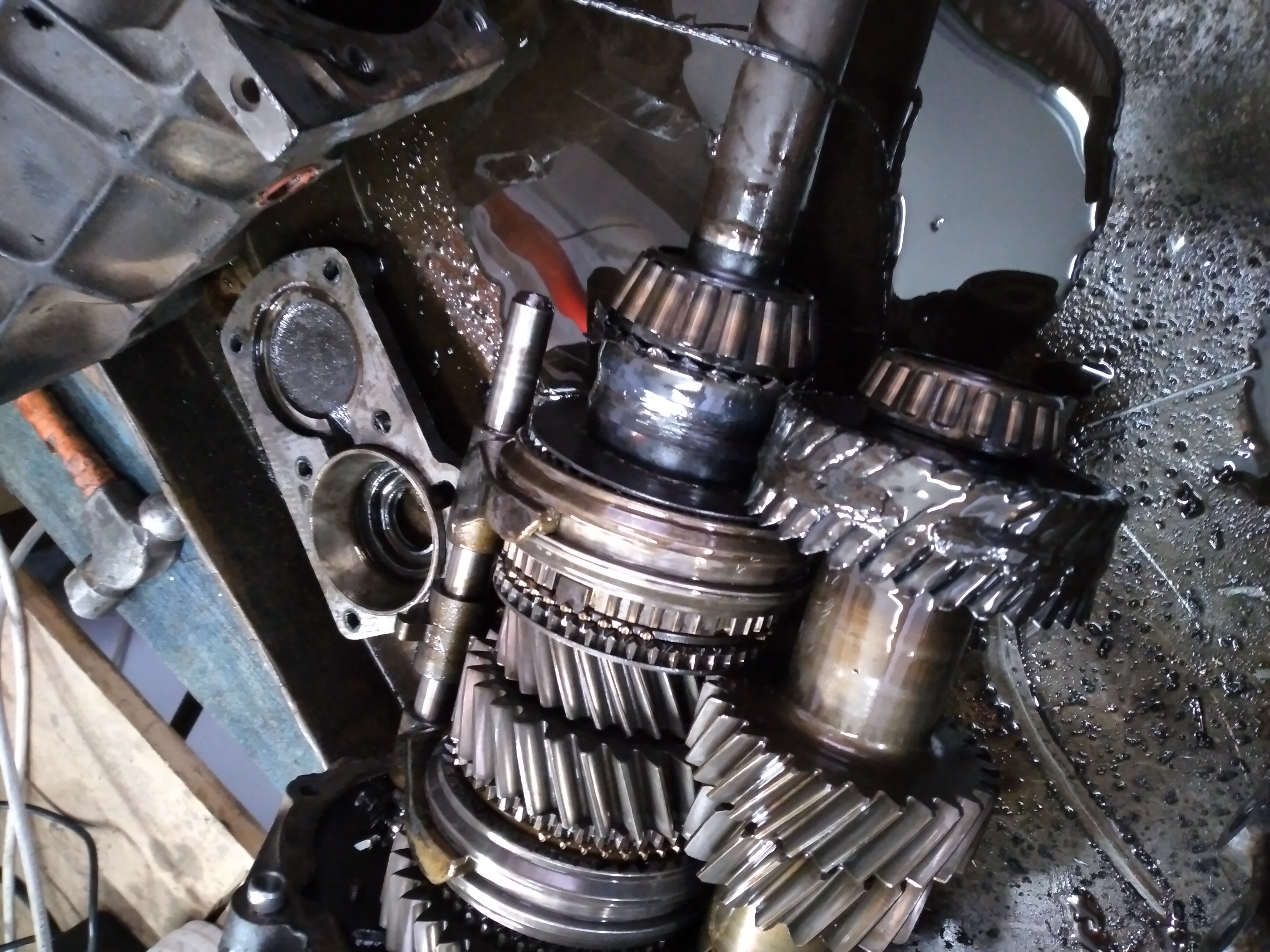

My R380 from my Discovery Td5 after it ate itself thanks to a chafed through oil cooler pipe....
