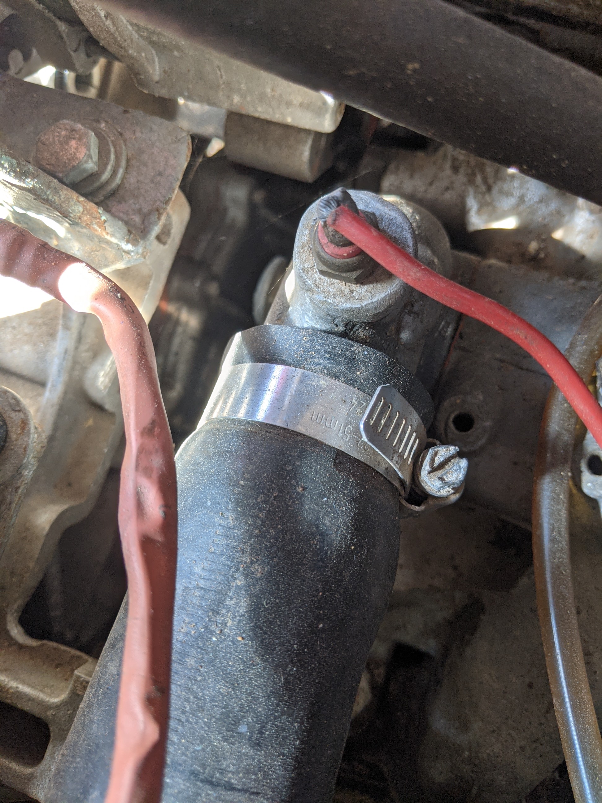

Unfortunately my 3.5 is not in a County but a 101 so the pics with it bolted up do not show much. The bypass pipe that goes to the back of the water pump is hidden deep down in the pics. I have this blocked at the moment with the S pipe that goes to the back of the water pump not fitted.
You can see the top radiator hose which goes to the left and then swings forward to the radiator - will be a slightly different shape on your engine.
On this first pic the front of the engine is the top.
On this pic the front of the engine is the top
On this pic the front of the engine is to the left

Thanks for that. Difficult to see the orientation as there seems to be even less room than in the County. I’ve seen another type of housing with 2 sensor ports which may also work. Frankly I’m not entirely sure what benefit the bypass to the water pump does! It’s certainly a pain in the A trying to find a suitable housing…….
