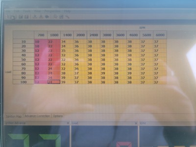

Re: EDIS timing map on stock rover v8 4.6 with 4.2 cam
allright gentleman, thanks for your contribution and input.
I had some time to spend and weather was acceptable 50 deg F with light breeze. that being said I plugged the lap top to the vehicle and changed a few numbers around.
the idle column was changed from 500 to 700 rpm, it made the idle much happier, I never realized i had an issue with it until it became smoother with the change.
all other columns were changed by about 800 rpm which placed my power band very tight with in the timing table. 6500 rpm was not a number on my rpm gauge on dash so it was moved to 6000 rpm.
the timing advance was reduced and adjusted from 1000 rpm to full rpm. road test revealed an initial cloud of black smoke which eventually cleared and continuous power right away from idle to last gear change, speeds up very fast and maintains a great power curve with better fuel consumption, a 60 mile roundtrip road test did not even move the fuel gauge from full mark. eventually rain forced me indoors so I have quit for now, with positive results. this is what I have now
still potentially seems a lot
I would also set the 2nd column where your idle speed is, so you have another column below it, which you can use to bump idle timing a little to increase torque if idle or rpm falls lower.
And no need for WOT at lower rpm's to have as much timing as that. And equally WOT at higher loads may still be a little high, although that's very engine/fuel dependent.
As they are not a high revving engine, you could have your upper columns stop around 4-5000rpm, as timing isn't going to be any different up there anyway, and give yourself more spread/resolution where you spend more time, around idle, off idle, low rpm
Just as a dizzy that will be all in by 3000rpm....will you really need different values over 4000rpm ? I would say unlikely in this scenario
And again, work out your low throttle cruise areas, high vacuum and bump these up, I'm sure they'd be perfectly happy low 40's
Stevie, if I understand correctly this is what it may need
700 rpm 10 deg
1000rpm 15 deg
1400 rpm 20 deg
2k becomes 1800 @ 25 deg
2.4k becomes 2.2 @ 30 deg
3k becomes 2.8 @ 35 deg
3.6k becomes 3.2 @ 37 deg
4.6k becomes 3.6 @ 38 deg
5.6k to 6k max of 39 deg
Please correct as needed, also all timing remains the same regarding load, correct.
700 rpm 10 deg
1000rpm 15 deg
1400 rpm 20 deg
Load is critical for timing - which this simple list is missing.95nas wrote: ↑Sun Feb 12, 2023 9:27 pm Stevie, if I understand correctly this is what it may need
700 rpm 10 deg
1000rpm 15 deg
1400 rpm 20 deg
Your timing advance on your table is not changing with load - only RPM. You have the same timing at 10% & 100% load.
100% is WOT (wide open throttle) this is were you should limit advance to 32 or so at 2800-3000rpm.
As I mentioned previously unless you have confirmed your base timing is correct - all these numbers are meaningless
- so you need to confirm a fixed 10degres EDIS timing is exactly equal to 10 degrees engine timing? Trigger offset:
Super, Stevie. thanks for the suggestion
I am in the US about an hr west of Washington DC, older land rovers specially non defenders are uncommon, which is where I come in with my classic.
seems I am one of the few in the us running a DIS conversion, the few guys with whom I have spoken at club meets, are running distributors.
when I ordered the Megajolt, I asked a few questions but never about map or tps, thus when ordered I received TPS type MJ box. I did have a bit of difficulty during initial install, because of miswiring the TPS to the MJ box. once corrected all else fell in place, here is a link to my past woes. viewtopic.php?f=11&t=15719
being it is an american based product, I do not know of it having been retrofitted on a popular manner as it seem to be the case in the UK. this last statement places me at a disadvantage with over all support, basically I am on my own. being a land rover, tunners around here decline to work on it so my rolling dynamometer is a road test.
I have read the first 2 articles SuperV8 suggested, they were included in the install CD, the link to MS... is an eye opener thou lots of excellent info
seems I am very close to optimizing this tune with a little bit of assistance and enlighten.
thanks for all your assistance, and please advise on where in the map to make changes, at what load levels and amount of optimum timing suggested.
