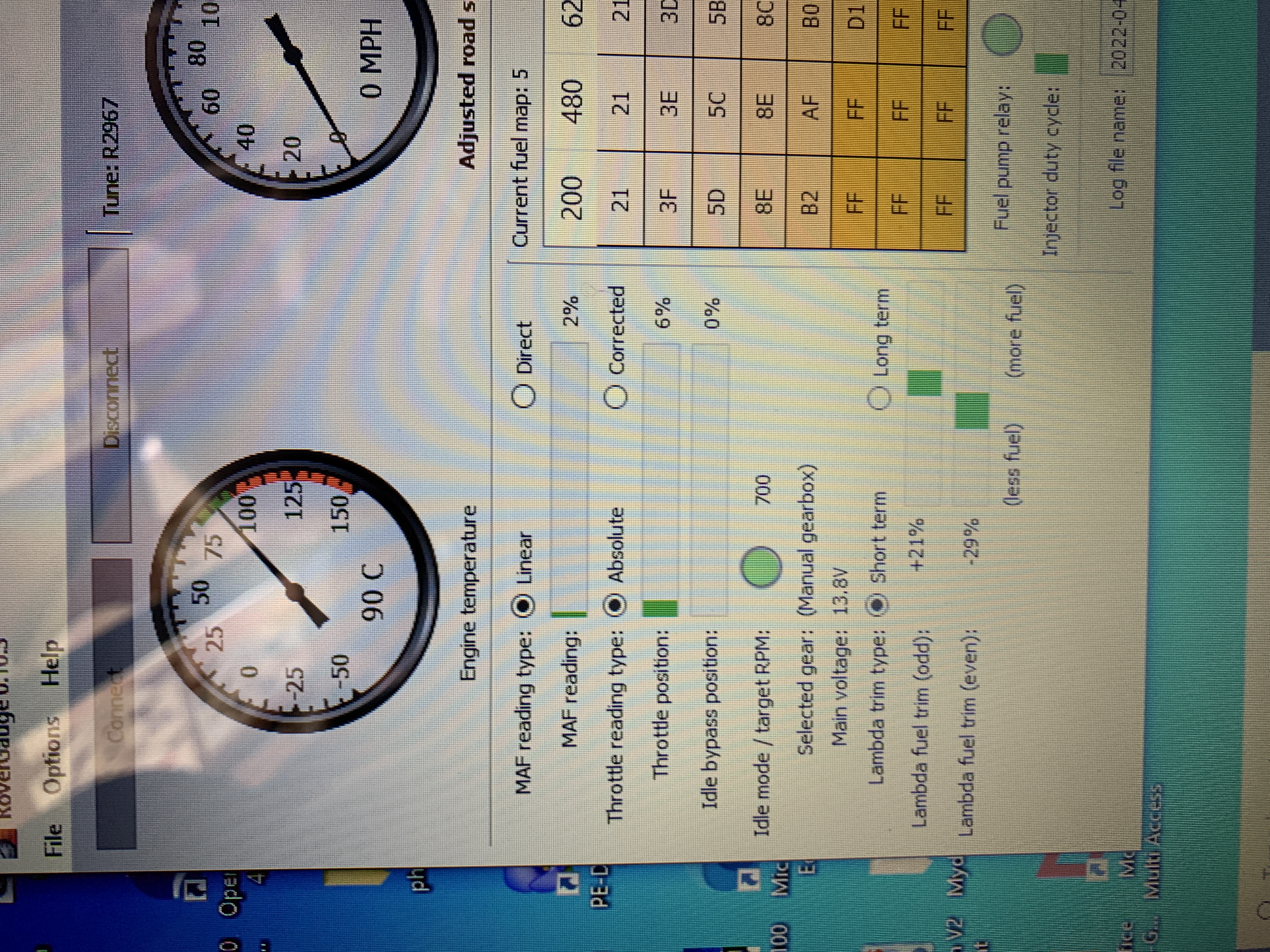

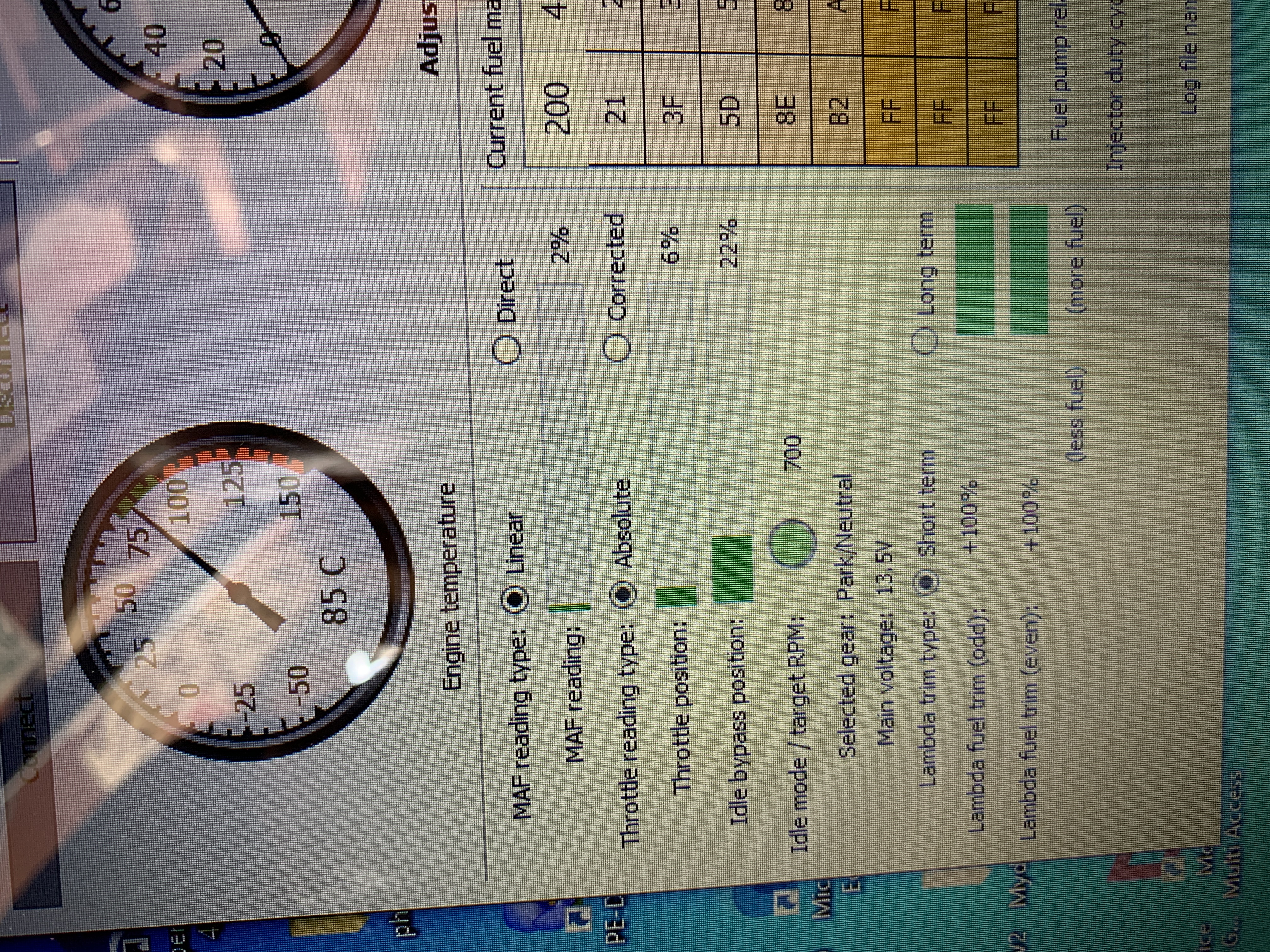

Finally got a chance to play today
before today the gear selected was drive/park and now its categorically manual, the 510 ohm resistor has had some impact
base idle was off at 600 as previous set, now at 525 with bypass airway blocked. Idles nicely at 750rpm connected.
lambda readings have changed markedly too
So I've made a change but if the stalling has stopped only time will tell. Need to get a few miles under the belt now I think. Next week......
( don't know why the pics are sideways)

Hi Grumpy
Not sure if I understand what has been changed here but there are some significant differences in your RG readings.
From you post it seems that you have added teh 510ohm resistor and maybe you tweeked the base idle. Was anything else done?
510Ohm resistor
You are now getting an indication of "Manual" for the selected gear which is consistent with having the resistor connected, my understanding is that the only diffence this should make is to set your idle speed to include the increment (typically 100 RPM) which is the same as you would get with an auto' setup when in park/neutral. You can see that the target idle is 700 in both cases which is consistent with this, if you were to leave the wire open circuit or ground it (simulating the gearbox switch operating) you would see a difference in the target idle speed. I believe this will drop with the condition for "in gear" but can't remember if that is open or ground.
I don't think this has contributed to the changes you see in the readings though. Although I've been wrong before
Base idle
If I understand correctly you have dialled the BI down from 600 to 525 however this does not seem to be consistent with what RG is showing. In your "before" graphic you have a target idle of 700 and an IAC valve reading of 22% (I can't see what the actuat RPM reading is as not in your graphic but I'm assuming is was nominally 700).
You now have an IAC reading of zero (nothing even showing on the scale) and you indicate that the engine speed was 750RPM, even higher than the target idle. That would indicate that the idle screw adjacent to the throttle plate is controlling the idle to the extent that even with the IAC wound fully in the system cannot achive the 700RPM target value. In other words the Base Idle is actually 750RPM.
I'm surprised the system isn't showing an error for this, I thought it got upset if the reading was below a few %, a figure of around 10% is in my head but as I've never had this issue I can't say for sure.
Either way this is a good indication that your BI is too high for the system to operate as intended but this is a "trick" used by some to get around issues with the road speed sensor and other IAC related problems.
Lambda trim
This is a bit odd and may indicate an issue although I'm not sure I'm seeing the full story.
Your "before" graphic indicates teh short term trims were maxxed out in the +ve direction, the system was doing all it could to increase the fuel being sent to the engine by increasing the injector open time on both banks. It could be that this maximum amount just got the correct mixture or even at max' fuel trim the mixture may still have been too weak.
I'm surprised the system was not showing a warning here too.
This would suggest low fuel flow/pressure getting to the injectors, I'd count out O2 sensor issues as this would most likely only affect one bank.
Looking at the "After" graphic it can be seen that the sort term trim is now within range on both banks, odd being on the rich side, even lean, but is being corrected by the system.
Looking at your graphic from a previous post I can see that the trim was being adjusted there within the limits but that time both banks were being enriched, odd bank more than even, which is actually as similar offset to your "after" graphic but with more enrichment.
Obviously this is a limited amount of information (would be interesting to see the full screen image and also the Long Term trim values) but I think I'd be looking at fuel delivery (checking fuel pump, filter and lines and monitoring fuel pressure when running) based on the variation in trim value you are getting.
It may also be a good idea to completely power down the ECU (remove the permanent live) which will remove the memorised trim values and allow the system to re-calculate them. And keep an eye on both the short and long term values thereafter.
Don't know how you are getting your screen images, looks like you are taking photo's. May be bette to use "Windows+Shift+S" to get a screen grab of the whole RG screen.

So you think I’ve made it worse? I don’t profess any expertise.
Base idle with the airway plugged was 525 rpm. When reconnected the idle was a very steady 750rpm. Bypass varying between 0 and 15% As you notice the bypass showed 0 I. The pic. Before adjusting the Allen screw the base idle was 600rpm rising to 700-750 when reconnected. Idle was unsteady, bypass fluctuating between 4-25%.
What else did I do. In order to add the resistor I disconnected the battery, unplugged the ecu and connected pin 34 to earth via a 510 ohm resistor. Before reconnecting the ecu I gave both sets of contacts a spray with contact cleaner.
I don’t think I have a method of checking the fuel pressure either stationary or running.
Thanks for you continued detailed replies.
Oh, images are photos as I’m using a cranky old laptop for RG but iPad to post here

Grumpy2 wrote: ↑Fri Apr 29, 2022 9:44 pm So you think I’ve made it worse? I don’t profess any expertise.
Strange that you have the base idle set at 525 but then it raises when you up block the bypass even though the valve position appears to be zero. Makes me wonder if the valve is not fully closing even when wound fully in, that's the only way I can see the idle rising when un-blocking the bypasss, also the only reason why you should have a value greater than the target setting. If the valve is already at zero postion the system cannot reduce it further.
When you disconnected the battery you will have cleared all the stored data from the 14CUX, this would have included the lambda trim values and may be related to why these have changed (for the better I'd say) this is not a problem, the system will re-establish them as soon as the engine is warmed up and certainly after it has been driven. If some garbage data was stored this would be a good thing.
I'm not too well up on this area as my car does not run cat's or closed loop.
I believe you can get a fuel pressure gauge which will screw into the schrader valve on the fuel rail. Don't forget pressure will vary with manifold vacuum.
I'm assuming the vacuum connection between plenum and fuel pressure regulator has been checked?

thanks again - you clarity and understanding are most welcome. I could replace the idle valve and see what happens as I have 3 after being told the the first one had failed and the second one failed because it was a cheap copy. But then it stalled again with the third (bearmach) valve in exactly the same manner. I'll pop it out over the weekend and see what's what.
Vacuum pipe intact and creating a reading when running - I have a vacuum gauge.
I'll have a look for the fuel rail valve and see if I can buy a suitable gauge. (anything in particular you'd recommend?)
thanks again
thanks again
