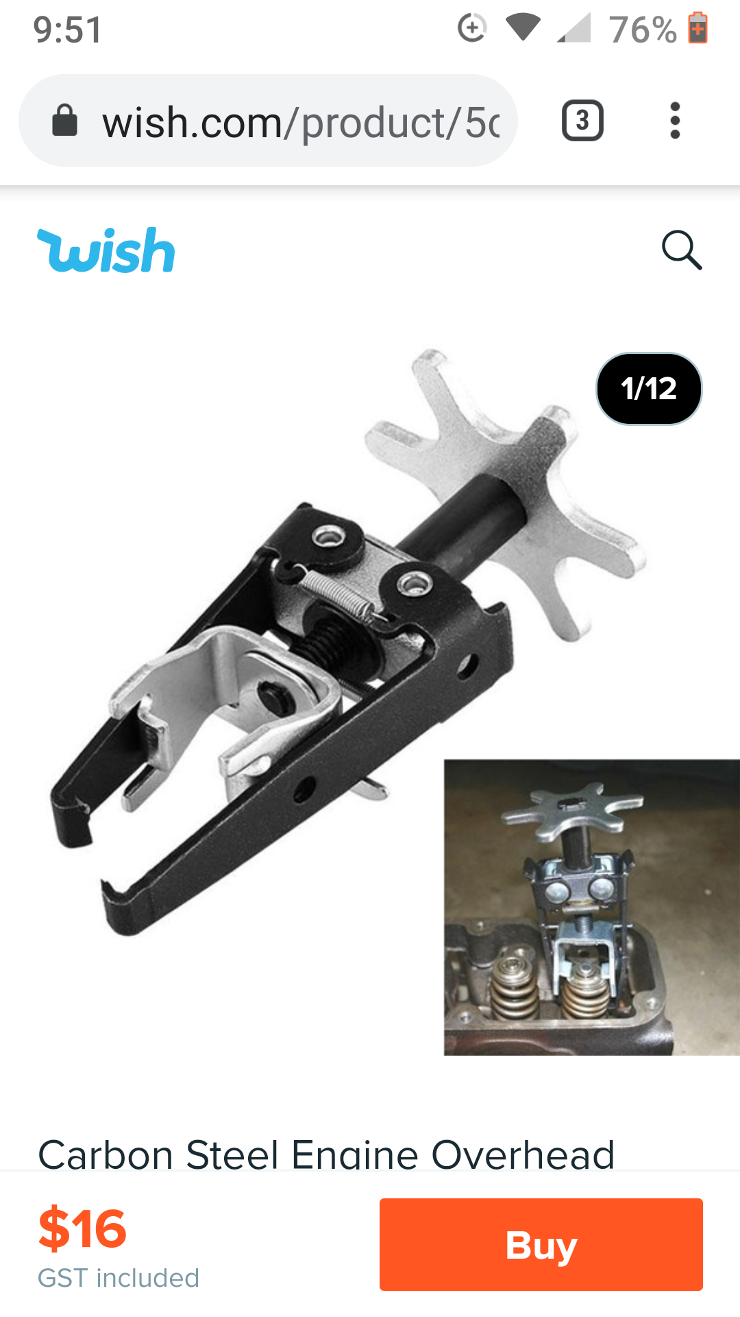

Even if you can bump the collets off with the hammer and socket ( and who hasnt 😁) you still need one of them spring compressors to reassemble
