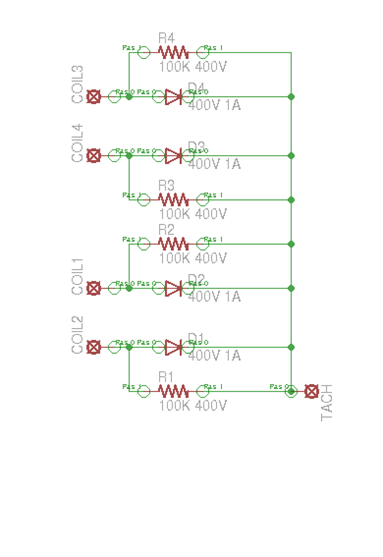

I dunno the 14 CU, but the older 4CU will happily trigger off a 5v logic signal, if you dispense with the series resistor. A tach which was driven off the coil negative (a pulse of about 50v) either requires a diode from each of the four wasted spark coils, or a pulse amplifier to drive off a logic level signal.

There is a tach signal output on the edis module but it never worked a normal tach. So I built a module from the below diagram - works great assuming you are using wasted spark coil packs.
This signal will also feed into the 14CUX tach input.

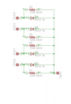

garrycol wrote: Wed Oct 14, 2020 12:50 am
GDCobra wrote: Tue Oct 13, 2020 5:04 pm I've had some good advice on the pro's and con's of EDIS and non-EDIS systems so thanks to everyone who contributed on that.
I'm still not certain of how to handle the coil signal to 14CUX/Tach but assume that there must be ways around this.
That's interesting Garry. The circuit's I've seen are similar to yours but without the resistors (as far as I can tel), effectively summing the pulses from all coils to mimic the current connection to the existing coil. I think I've also seen a diode on the output line too.

DaveEFI wrote: Tue Oct 13, 2020 6:09 pm A tach which was driven off the coil negative (a pulse of about 50v) either requires a diode from each of the four wasted spark coils, or a pulse amplifier to drive off a logic level signal.
I've seen circuits available which are built along these lines (as per diagram in Garry's post) so I could buy one of these or make something up.
As I say it's been a while since I played around with electronics but I don't expect diodes and resitors have become too expensive (although I've been wrong before)!
