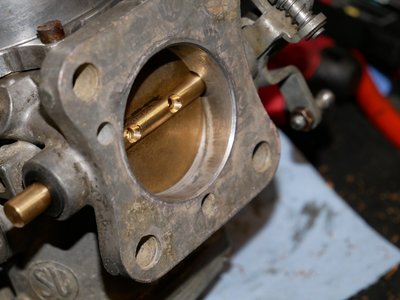

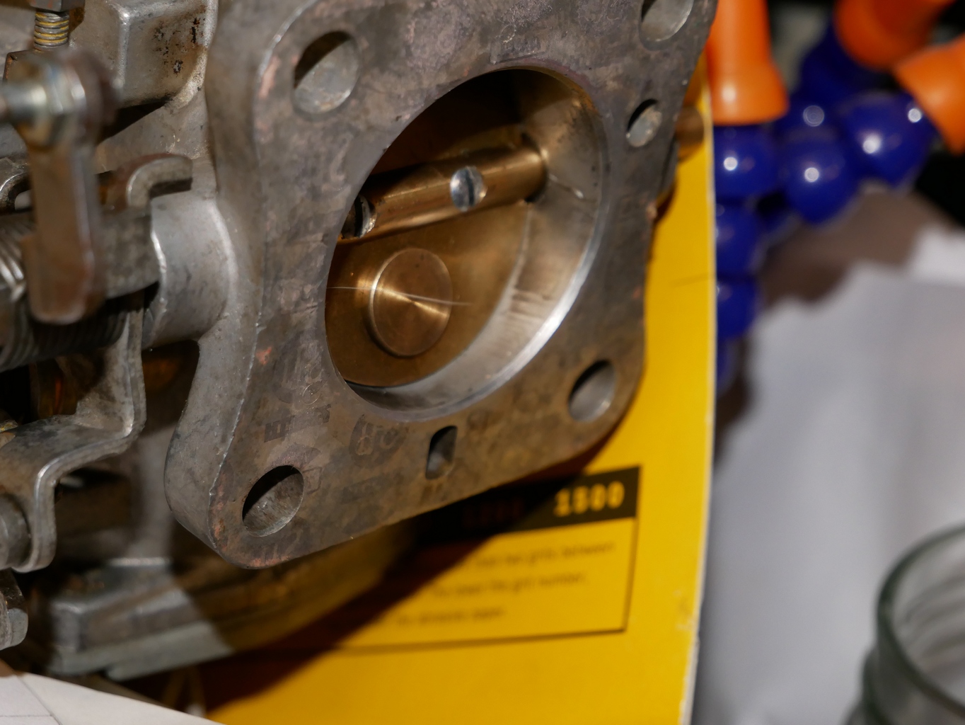

Well it turns out I wasn't far wrong about the throttle plates.The flat set I fitted from my other HiF44s are a fraction smaller on the vertical plane allowing them to close further,by quite a bit actually, and interfere with the fast idle cam.I measured them horizontally but not vertically before I fitted them I must admit.I'm guessing they're a racing mod as the carbs they came off have no cold start assembly fitted and so didn't have interference from it.So I've refitted the new replacement poppet plates and the throttle all works together now and rests in the correct place (as indicated by the oil stains and carbon).I'll refit and test tomorrow hopefully.
Flat throttle plate closed (no idle screw)
Poppet throttle plate closed (no idle screw)
