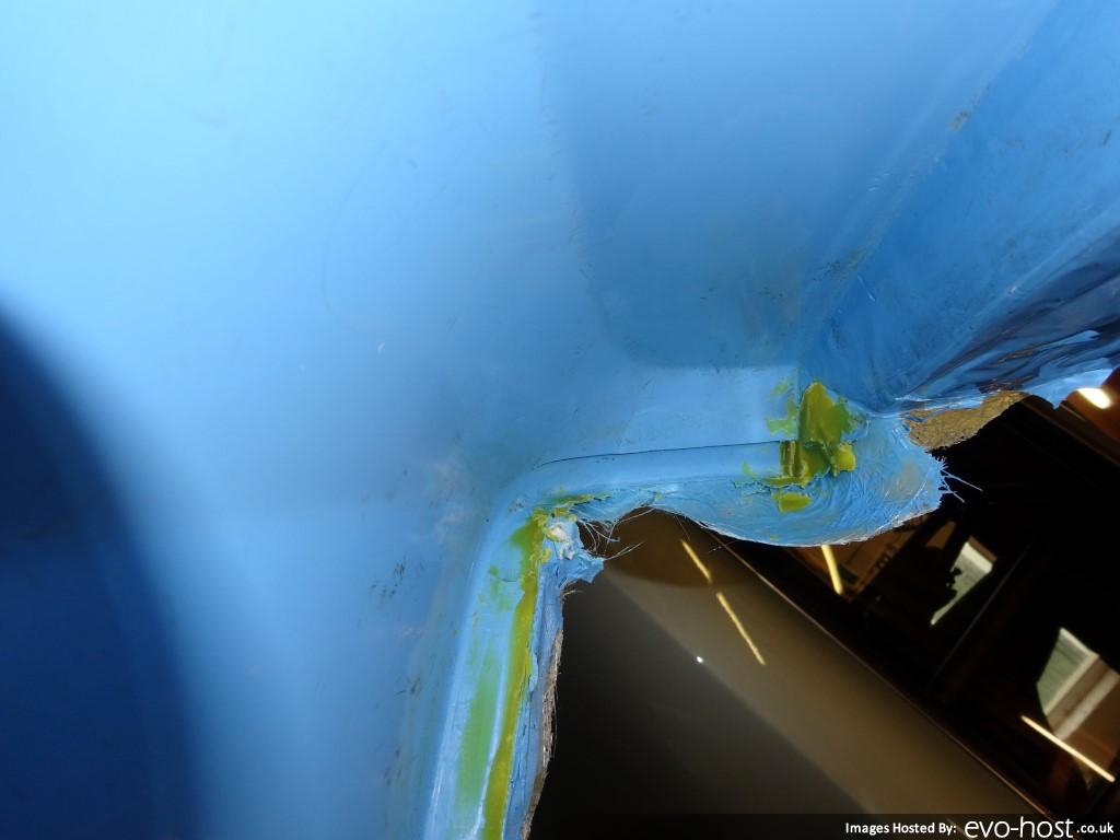

There is also an area on the mould that the gel was too thin and I have gone through to the laminate - I will have to cut this back and gel.

And I got to wondering what you meant about the Yellow Wax?stevieturbo wrote: But I'm also sure it blew the yellow wax everywhere too all over the mould surface which then needed cleaning off.
No doubt with a much stronger mould there would have been less flex and it may not have helped as much, but it was a first couple of attempts and didnt want to make anything too strong in case I ended up entombing the wing forever if it didnt come out !
Andrew
4.5L V8 Ginetta G27
- Posts: 4098
The Bee's wax for adding shape, filling crevices etc to the original part before making the mould.
You can see here where I waxed around the backside of the chrome trim etc to secure there would be no locking points when trying to remove the mould.
And the wax that then needs cleaned off from inside the mould ( this mould was my first attempt, not the same as photo above )
When wax is removed here it should leave a finished shape for the new panel.

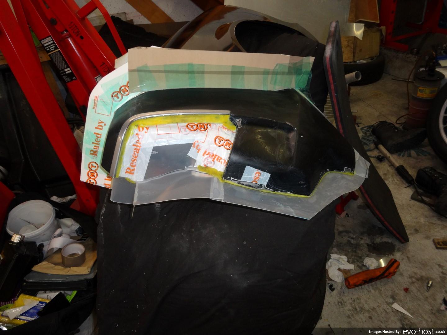

I deceided that the next test may as well be in the actual mould and have a go at making a very lightweight half bumper.
I had to extend the mould a little for ease of making the part so cardboard/masking tape/hot glue gun. Must admit to being very impressed with this little gun. The one I had before would best be described as a warm glue gun compared to this one.
Then in went some Black gel - A bit much if I am to be honest I should have applied it a fair bit thinner - lesson learned.
I am only putting down Gel/225CSM/228Cloth for this layup and the part should come out at about 250g and be purely decorative.
The internal finish comes out very smooth.
Will give it a couple of days in the mould then pop it out and have a look at how to do it differently the next time

I must have the PVA application off pat now as it popped out the mould like it was was allergic to the colour green.gelmonkey wrote:Will be watching closely Mr Andy
Looking good so far mate
I trimmed it down and it weighed in at 201g with a little more trimming to go. so would be under 200g when done. The lay-up is only about 1mm thick and it only make a decorative cover - for a super lightweight race bumper thery would be OK but not for road use with a bit of structure.
I will do a lay-up with another round of 225 and 228 which I hope will come out at about 360g and be far stronger.
Surface finish was very good.
