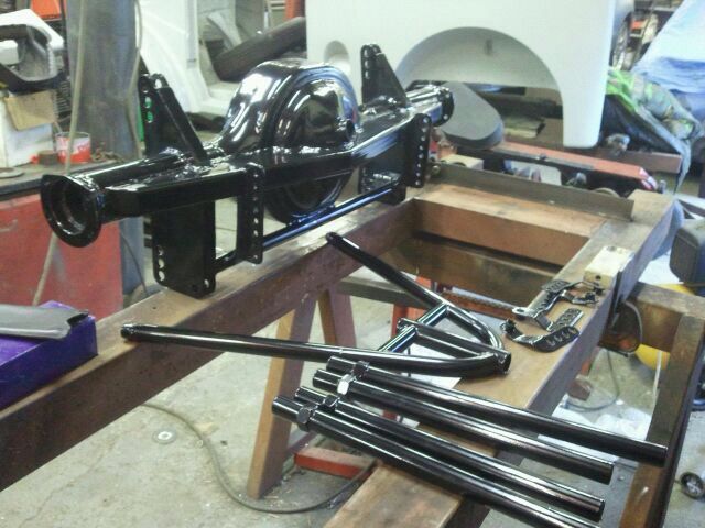

Here's mine after coming back from the powdercoaters,
Strange shafts live inside mine
very nice, how many horsies are you planning to shove through that little chap then, you have some serious bracing on the case. . .
Nice chassis table you have there sir, no chance of me renting mine to you is there!

Not my table,belongs to my mate (Large Engineering) who braced and converted my axle from ladder bar to four bar,power is 420, extra bracing as I have over a yard of rubber on the back !

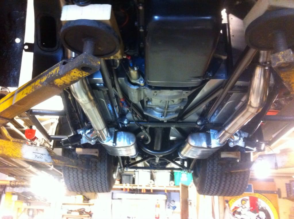

I see, very sensible. I didn't know where the 9" came from. If it'll run those yellow buses, I'm sure it'll be OK in a knackered old MGBV8!
Hi Chris
they turn up in all sorts of stuff, Ford in the US like GM share parts bins across divisions far more than the European equivalents. The big block engines are truck (lorry) engines really, that is why Chevy big block will bore to +125 thou, they are intended to be in tractor units that cover 250k miles a year, you run one engine rebore and rebuild a second, that is why rebuild kits are so cheep, they sell a lot of them. Likewise the core business for strange and Moser and col is an aftermarket keeping peoples work horse trucks going, not racers like me and Perry that is an add on. People over here forget just how cheap petrol is in the US the 351C ford engine was designed for delivery trucks (3 to 7 ton range) but they ended up in loads of ford cars.
