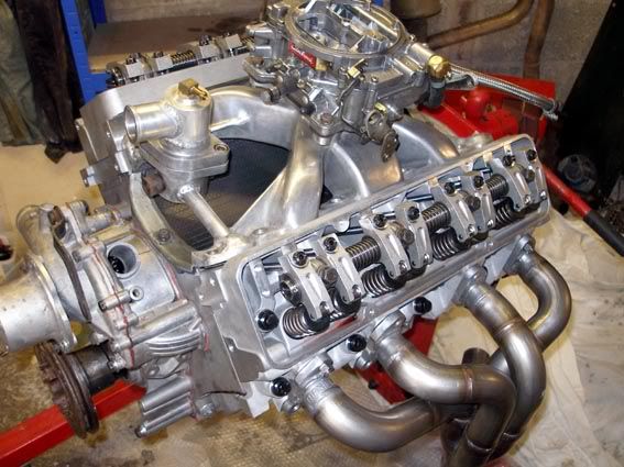

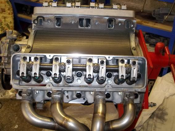

I know we have slightly different setups but with the lash caps installed I was not happy with the angle that the top of the pushrod was sitting in the cup, which meant that the pushrod was not pushing squareley in the cup. Hope that makes sense.
I have decided to leave the infilled corner on the inlet and just remove the small amount of casting flash from ports and runners.

As I have previously suffered with over oiling at the rockers I dont really want any more oil supplied to the top end. To overcome this i have modified my solid lifters to prevent oil entering the pushrod. So now the lifter cup will be supplied with oil from the rocker shaft.
Adjuster end of rockers make contact with the rocker covers by about 4mm so will get some 10mm spacers made this week then the engine can go back in.

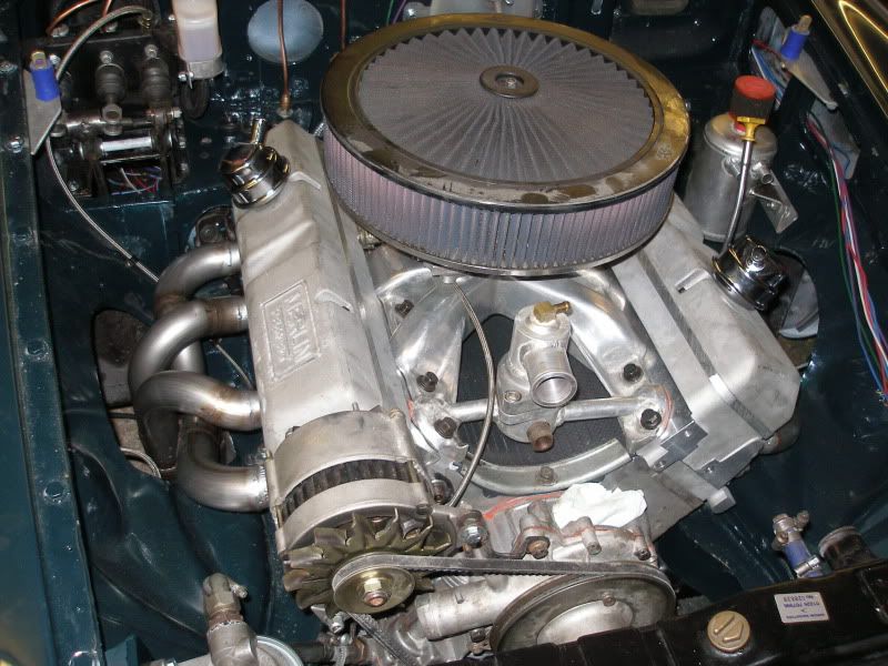

I have also fitted 10 mm thick spacers.

I had to remove the roller rockers because they were making a lot of mechanical tapping noise. I first though that the rockers were hitting the covers despite the 10 mm spacers but found out that this was not the case. I don´t know what was causing it but I did not have enough time to start investigating. I put the old crap back and no more noise.
The hew shafts have smaller diameter than worn std shafts so maybe the excessive clearance is the culprit. The ratio is the same 1,6:1 so there should not be more lift tha might make the valves hit the pistons.
Mine came from Rimmer Bros. I contacted them and all they had in stock were the same size. I think they were 20,52 mm or something like that and the worn std shaft was 20,61 measured from the middle of the shaft (between the adjacent rockers).

I made up four rocker shaft end support brackets to fit the Yella Terras roller rockers on my Buick 300 heads after a shaft broke at the overhang during some over zealous driving of the 4.6 SD1.
To get clearance for these rockers under Rover P6 rocker covers I use two Felpro rubber rocker cover gaskets glued together.
