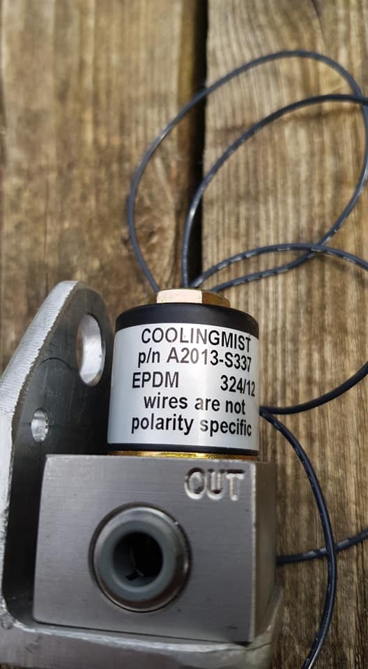

we are now playing around with water injection on the engine :lol:
Injector boss made on the lathe and recessed to fit boost hose,
Bracket made to mount the water solenoid to the inner wing,
Water tank mounted in the boot,
Pump also now mounted under the boot floor panel,
Boot floor back in hiding the pump and electrics,
Even the parcel shelf still fits,
And a system and leak test,
https://youtu.be/XBBJU9OUJaY

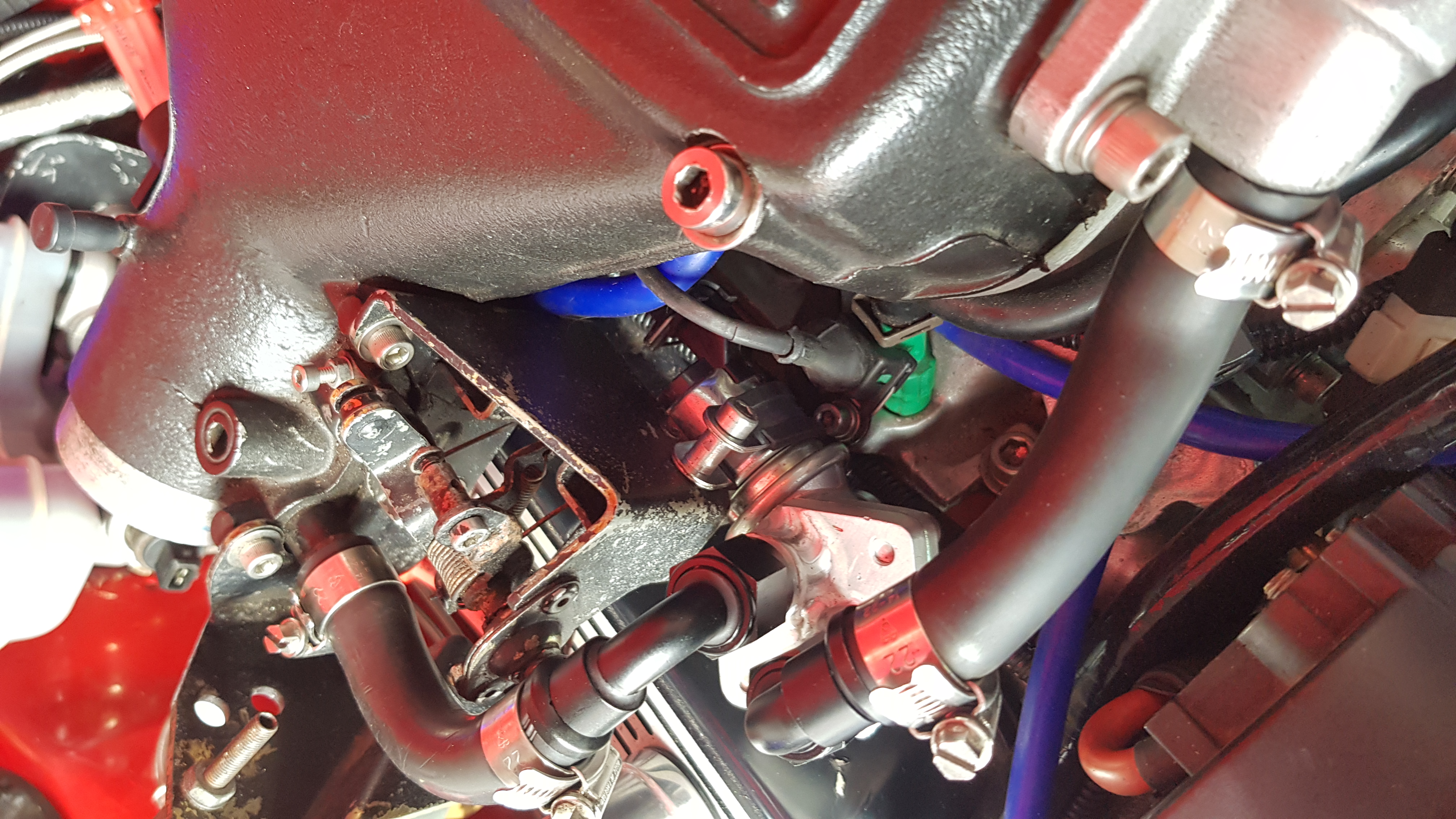

New idle control set up fitted today.
This will now do away with the stepper motor.
