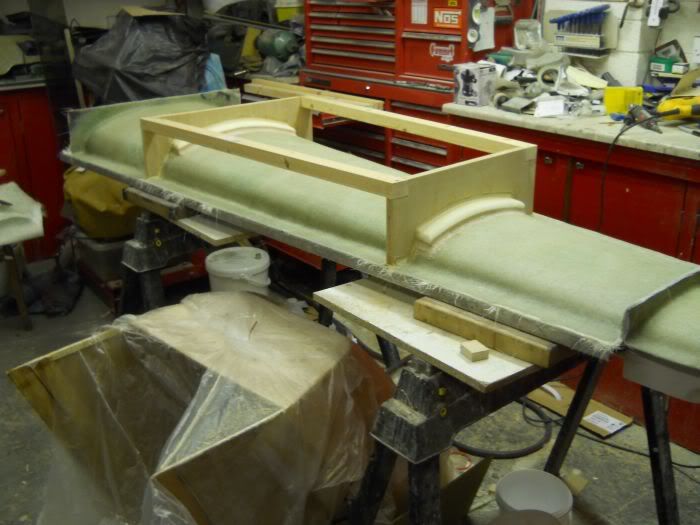

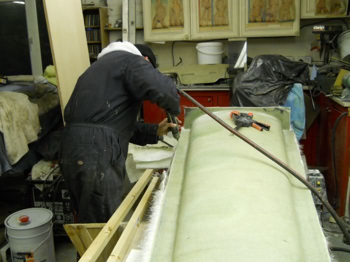

Here we go then with the cradle section.
The main section was roughly trimmed down with the air hacksaw for two reasons.
1 Getting glass splinters in your mitts is not so good and unless you get them out right away they casn work their way in and stay there for good.
I have splinters in my fingers that have been there nearly 30 yrs.
2 When I'm working I try to keep my station as clean as possible as this for some strange reason just 'feels better'.(Yeah I know WEIRDO)

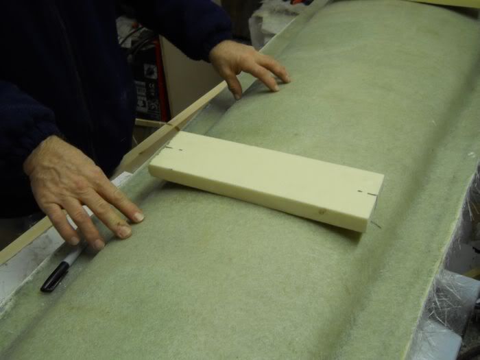

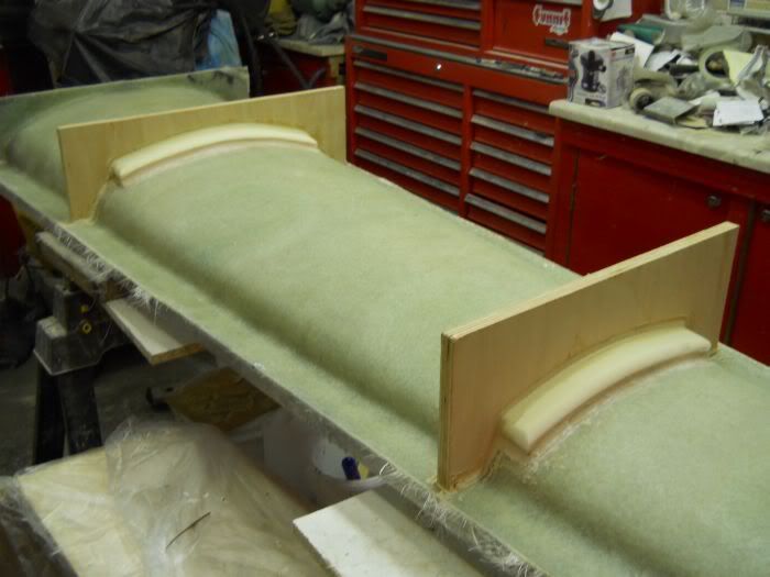

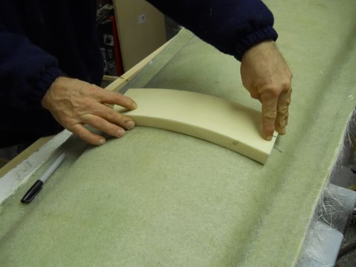

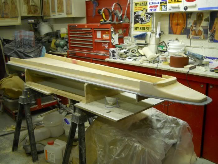

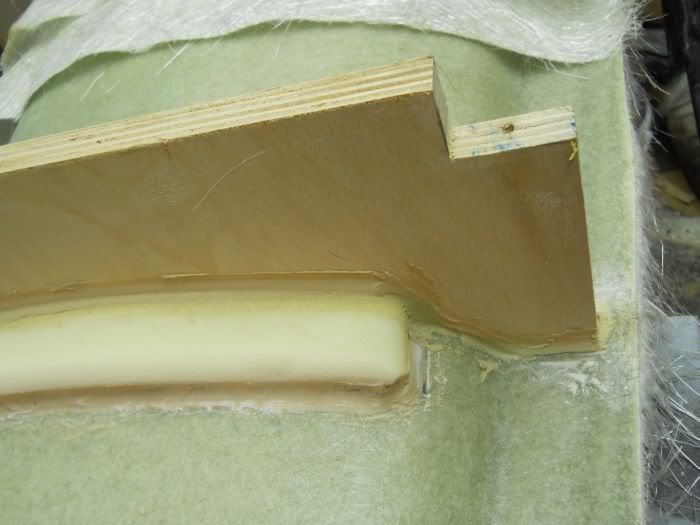

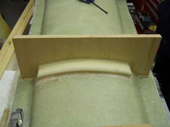

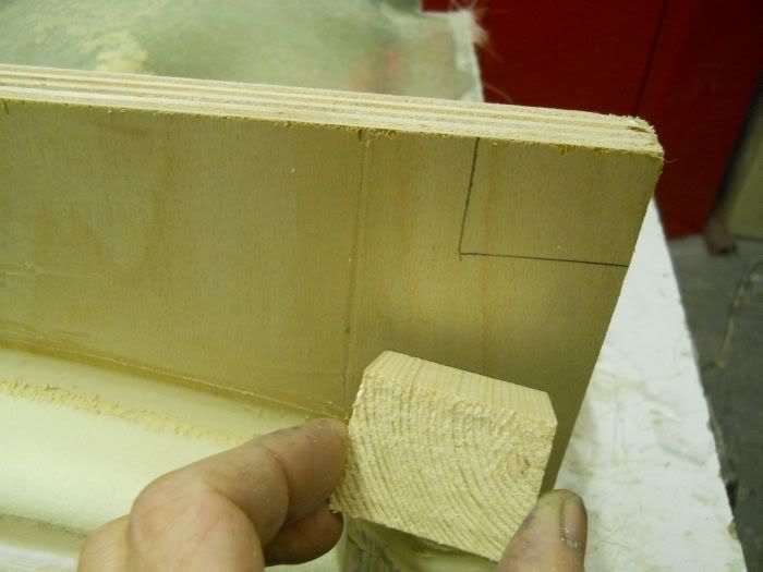

With the mould trimmed down it was time to break out the 1" thick bracing foam and cut that to size.
The foam is fairly rigid but with a bit of persuasion it will bend.

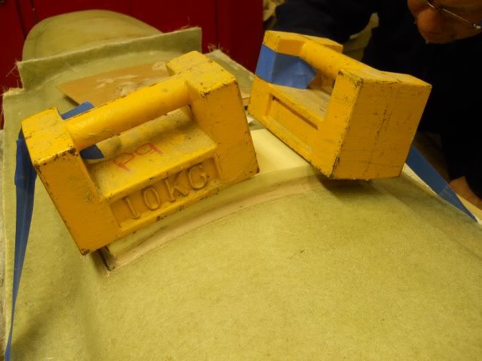

With measurements of 20" from each end of the flanges the areas were marked out on the laminates and then skimmed with car body filler and plonked into place.
They were then held in position with pig blocks (or kin heavy weights with handles on them)
It should be noted that the CAVE TROLL hands belong to my very good friend John who came down to help for the evening.
Brilliant craftsman but absolutely crap when trying to weld stainless steel,another story another time that one eh John :lol:

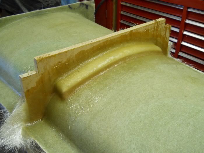

A good point to note at this stage is that all Polyester resins and fillers go through a stage of exothermation which means that they generate heat as they cure and then as it cures it shrinks back causing an almost vacum like situation which then transfers to the mould itself and with something like this it is much better to do a slow/minimum hardener mix which allows for curing without pulling the underlying substrates away from the plug.

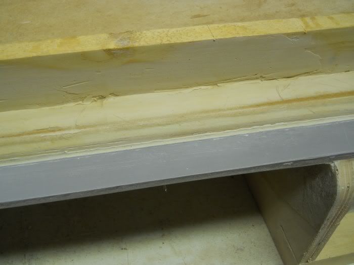

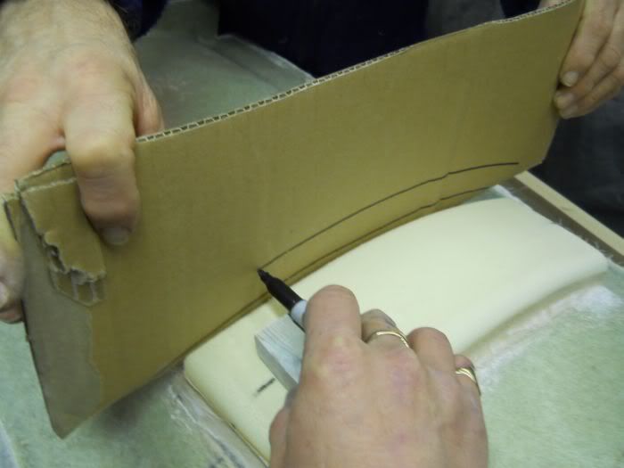

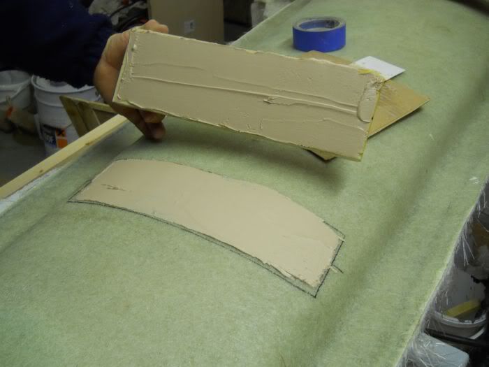

As the filler cured on the second brace we cut some cardboard and scribed the shape of the first brace to transfer to wood once we were happy.
And then cut to fit and coved in with filler.
The same was done on the other brace and we ended up with this.
The corners were then cut to the shape of the timbers being used for the base lengths.
The base lenghts were then screwed onto position, trimmed and that was that, cradle completed.

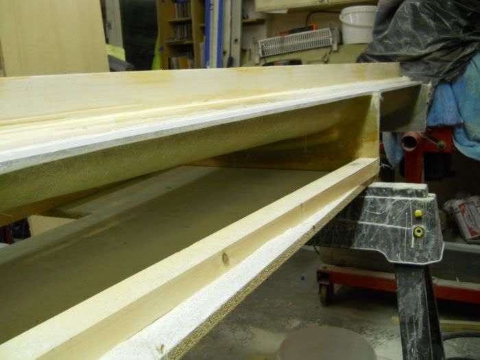

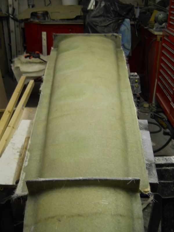

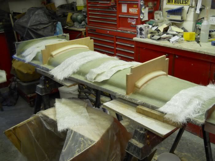

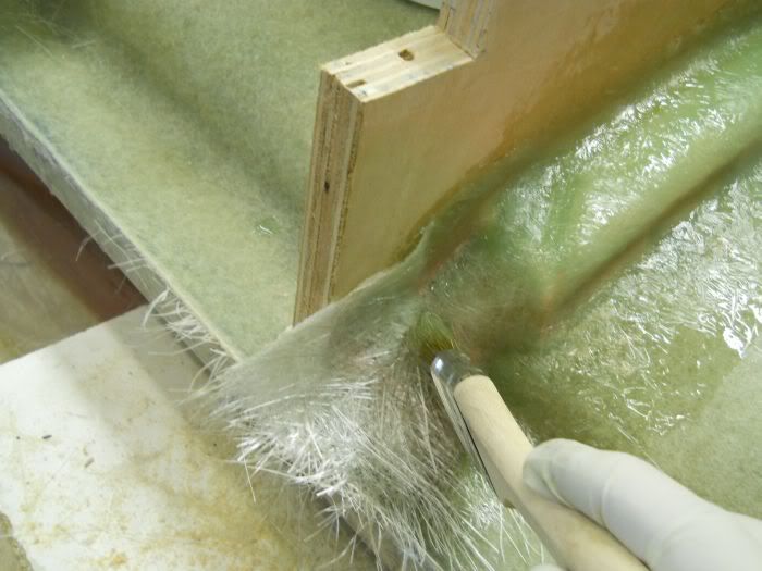

Here we go again then ,glassing in the cradle.

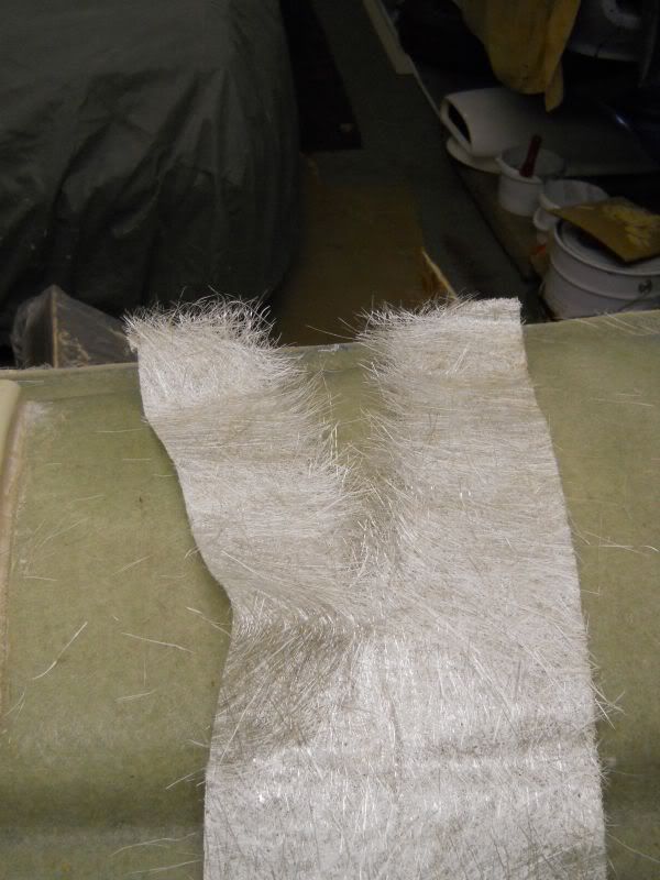

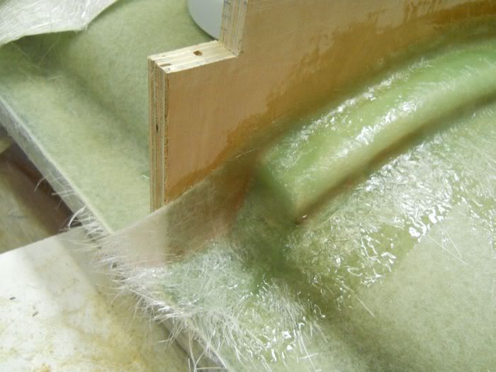

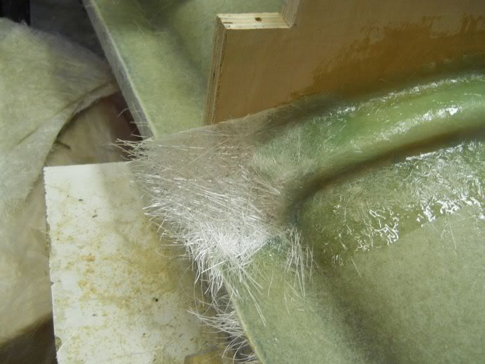

Using off cuts from the main section laminates these were first offered up ,torn to rough size and then split down the middle.
Once all sections were done they were layed out right to hand (much easier to work like) this.
Resin mixed wetting out begins.

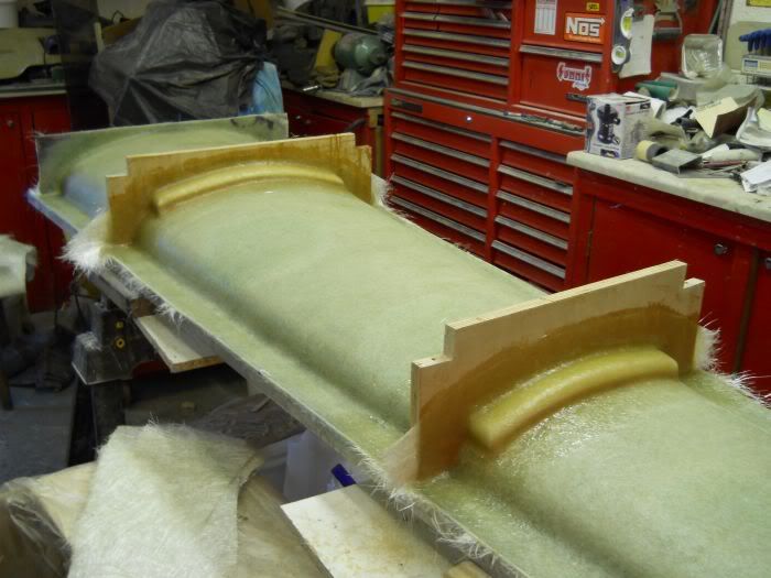

I like to put the cut edge of the laminate to the top of the timber as the torn edges can be rollered into the main laminate section and you can get an almost seamless joint,it also makes it stronger.
As you can see from this next shot there are a few corners and drops to work and it can be a bit tricky but if you take your time you can gently ease the laminates into position.
Just keep teasing the laminates with the brush and the little buggers will go in eventually.
Keep working away and in a short space of time you end up with this.
This will left to cure now overnight and then trimmed tomorrow evening.
Allow yourself plenty of time for curing even on small sections like this.
The timber lengths can then be re attached and the mould turned over for the final stages.

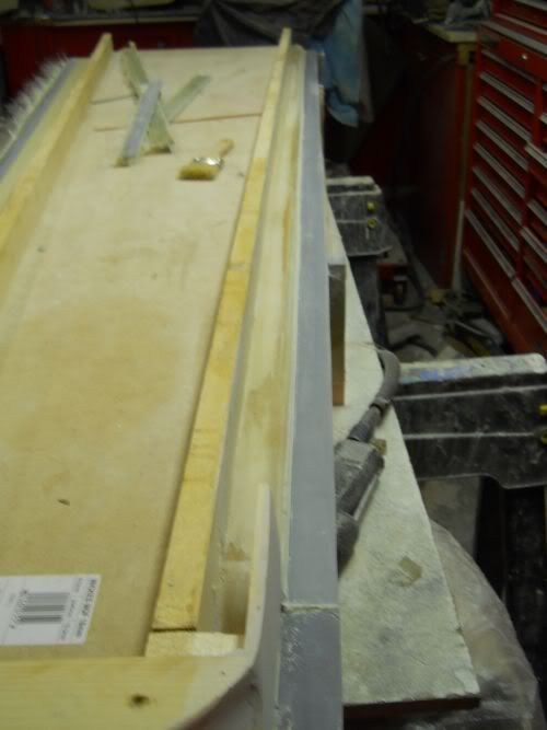

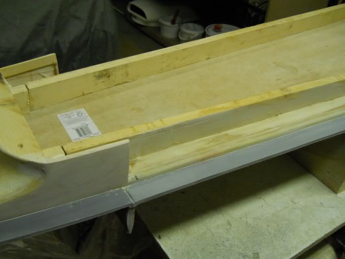

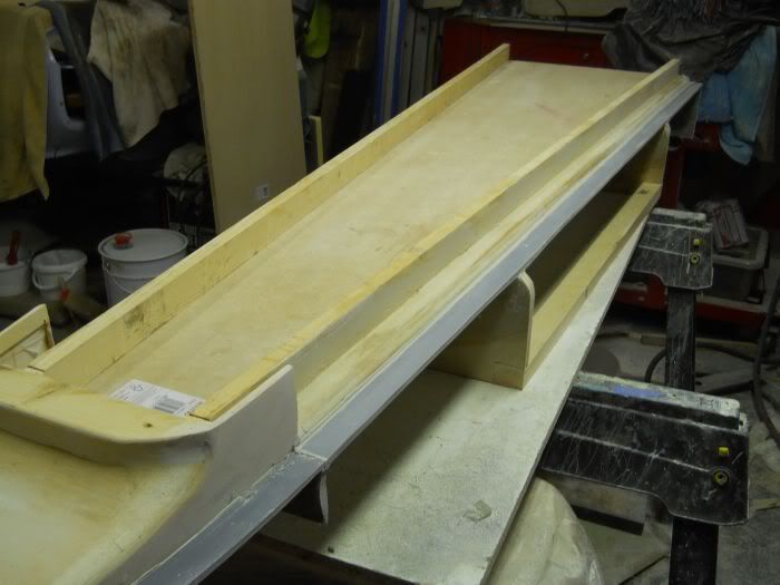

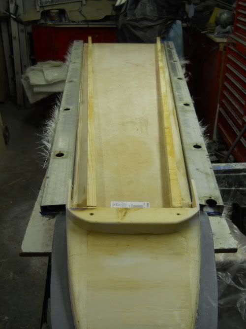

Having dressed up like Nanook of the North this evening because it was bloody freezing I ventured out to the play house and carried on with Mikes mould.
Here are tonight's efforts.

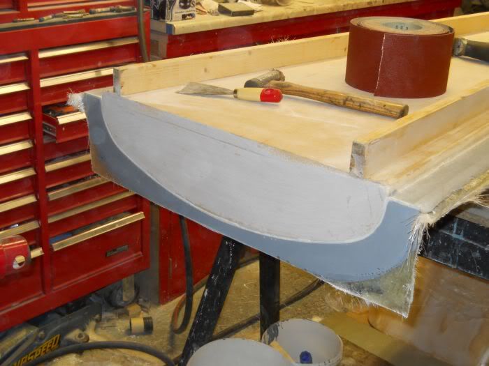

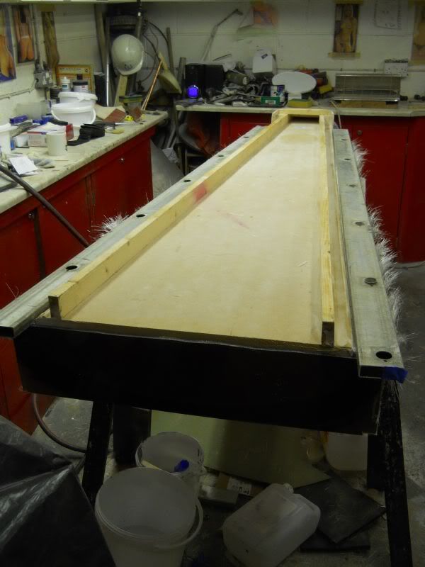

After screwing the timber lengths back on the mould it was turned and this was mine and your first proper veiw of the underside.
The next thing to do was release the fences and this was accomplished by using a wide paint scraper pushed into the now underside joint.
Gently tapping it up the length with a rubber sledgehammer the fences could be heard popping and sucking and then as if by magic the things came away in me 'and (How lucky was that ?)

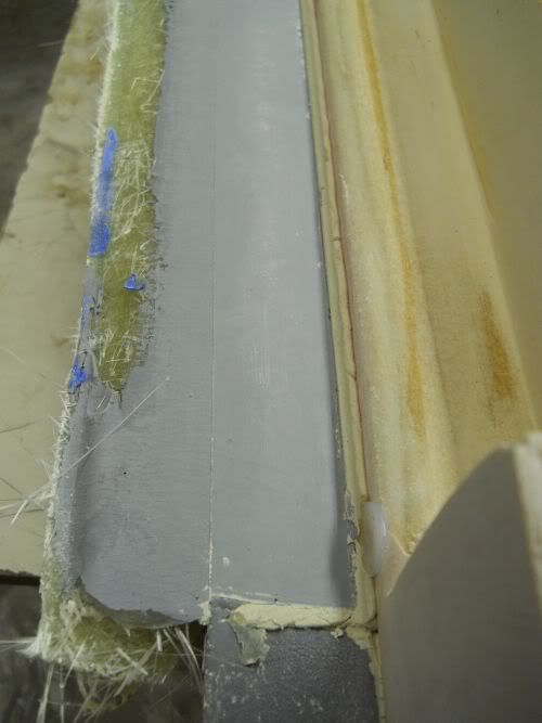

Now remember the blue tape a little while back?
Well now all will become clear,the gel takes the shape of everything it flows over and once the fences are released you have a perfect cut line to follow and to make your flanges neat and tidy.
Also remember that the gel and the glass were taken out over the tape.
Well when you cut down the tape line you can virtually guaranttee that the laminate thickness will be the same for the full length thus making you a smart arse :lol:
The edges of the cradle where they meet the flanges can then be shaped and I use a power file for this task,quick ,clean and simple to do.

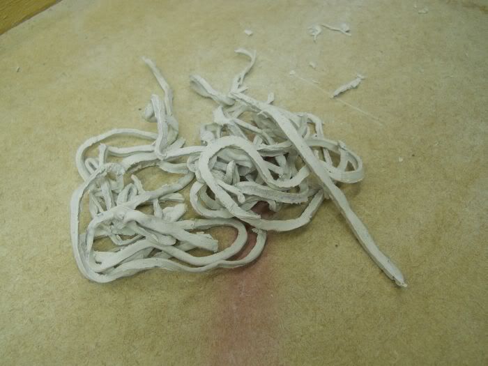

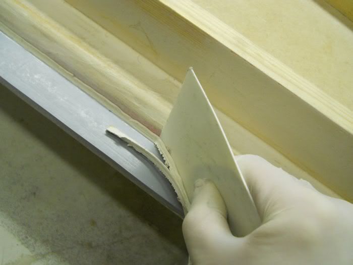

The next thing to do was scrape out the plasticine and a body filler spreader was used as it causes no damage to the plug.
Keep going until you end up with a bundle of snakes.
Don't throw this away it will be used again.
With that done a quick sweep out of the joint with a brush and then a wipe over with acetone and we end up with this a really neat joint and a locating ledge for the full length of the mould on either side.
That completed we can see Mikes version of the Bullet Train or Bullet Slingshot if you like.
