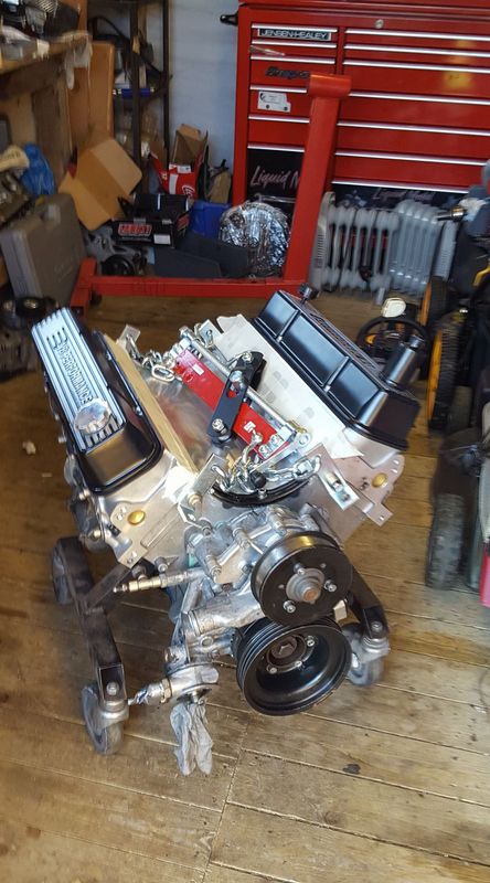

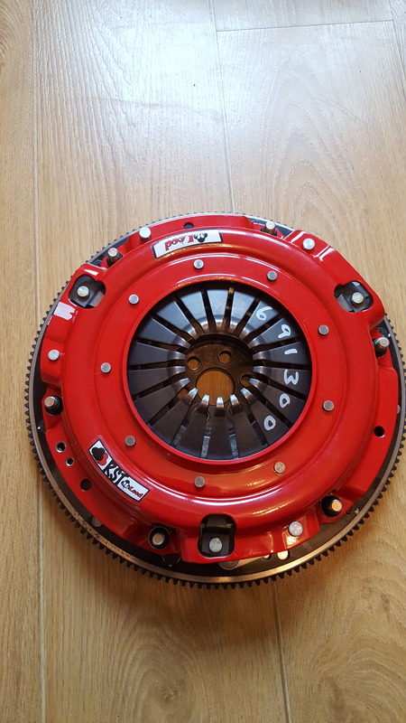

Flywheel has now been machined and had the RST adaptor fitted, balanced and returned back to me,
[attachment=0]c4.jpg[/attachment

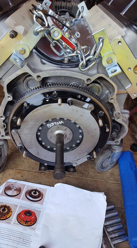

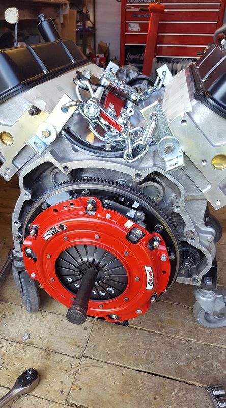

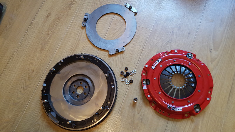

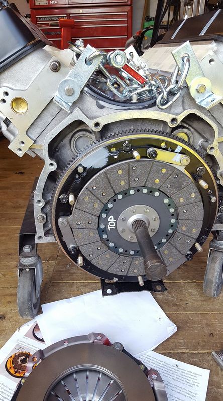

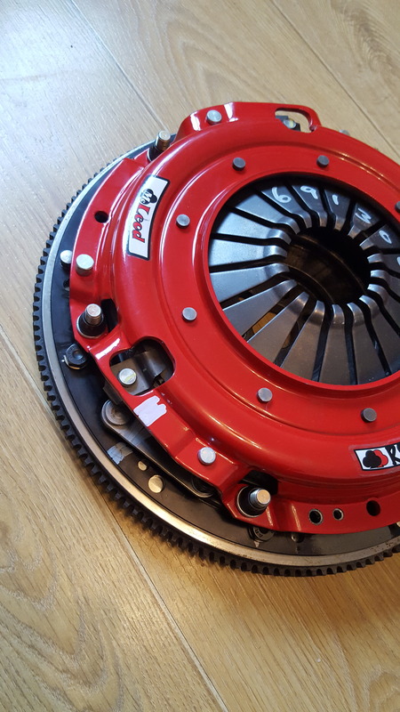

Well after 2yrs its time for the engine to divorce the engine stand
First plate and adaptor fitted to flywheel
Second plate fitted and lined up,
And all finished,

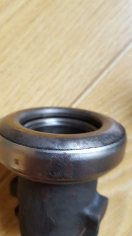

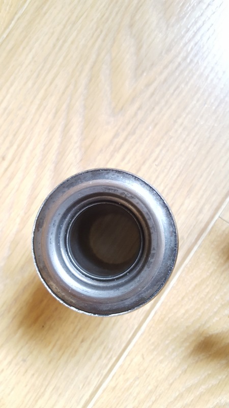

Right guys need some help as I'm getting myself so confused now,
am I correct in thinking I need the flat faced self centering bearing to go with this RST cover plate and not the domed type bearing face one I have sat here from my old clutch???
Posted: Mon Apr 10, 2017 7:40 pm
by stevieturbo
Post a picture of both ?
And how does each look when applied to the fingers ?
There's a good chance either cold work....but if the fingers had been flat, then a flat bearing would not work ( for long )
Posted: Mon Apr 10, 2017 7:49 pm
by Coops
My current one:
Posted: Tue Apr 11, 2017 6:36 pm
by Coops
you recon that will work ok then stevie?
Posted: Wed Apr 12, 2017 12:19 am
by stevieturbo
Again, place it on top of the fingers and see how it looks.
The bearing will only travel say 10mm so there isnt a huge range of movement. If the fingers are fairly close to the centre of the bearing then I wouldnt have any concerns.
The bearing they ( not McLeod ) sent me for my clutch has me more worried...but it's working lol
If the flat part of your raised fingers where either too close to the inside or outside of the bearing, then I probably wouldnt be happy with it
