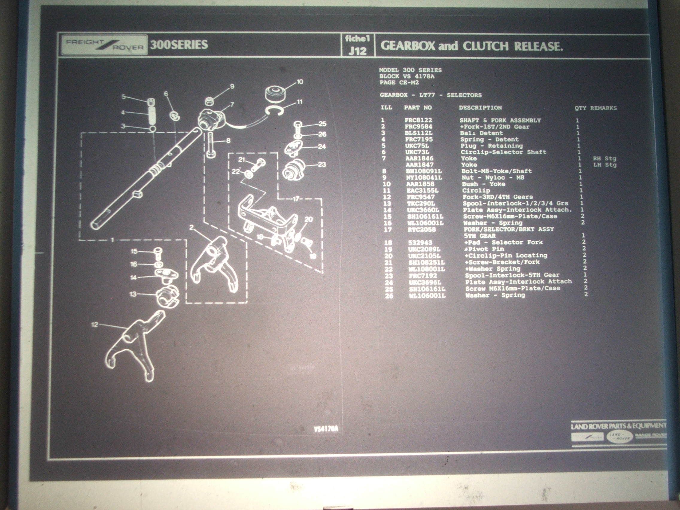

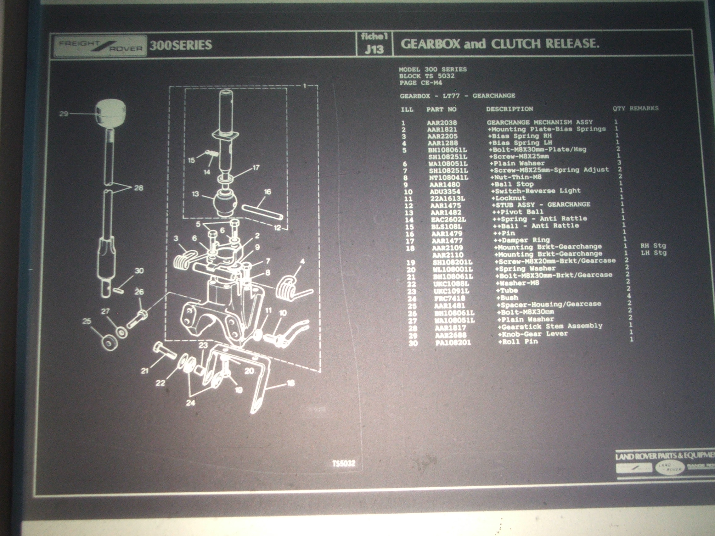

Not sure which bit you mean. Have you a picture?
I have a microfiche of the LT77 Sherpa 'box, so I can probably get the proper part no if I'm clear about which bit it is.

Posts: 5078
Apologies about the size - in aid of readability....!

Thanks Chris, perfect!!!!!
This is the part I'm on about..
According to your picture it's item 7 and the bit I need is a replacement for item 10.. (I'm gueesing the brass ball and retaining cup are one assembly?)
