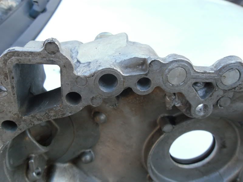

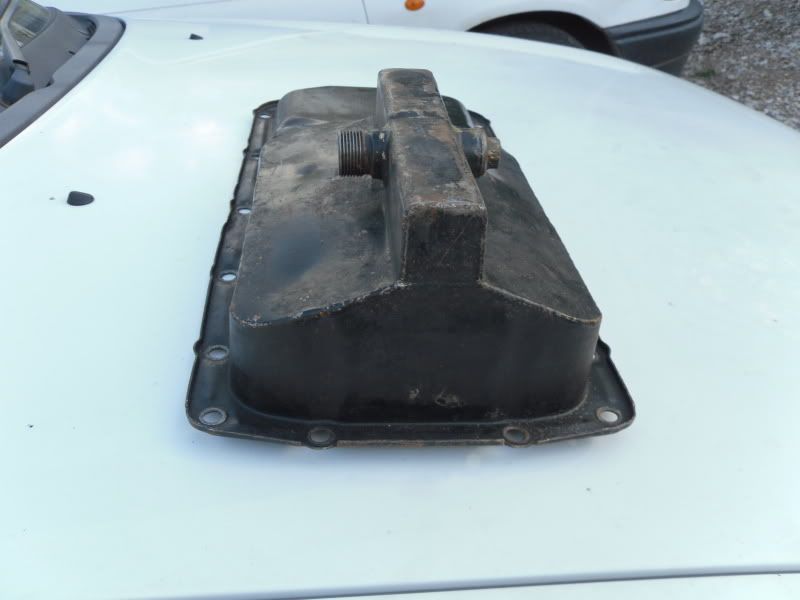

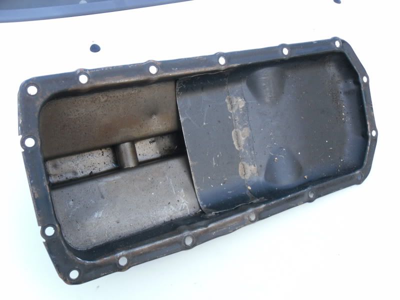

Hi fellas, opinions on this please.
Properly made dry sump pan and modified cover, made from a modified standard pan, but looks very well made in the same ilk as a BDA dry sump would be made, but, it only has one scavence port, will this be enough? Most engines I have built hav had at least two scavenges. Secondly, the cover has had the pump removed, and the port drilled and a oil adaptor fitted for the pressure inlet, in my eyes, as long as this enters the gallery somewhere, it's ok, this is exactly where the std pump would feed anyway so looks good in my eyes.
Look forward to comments................
