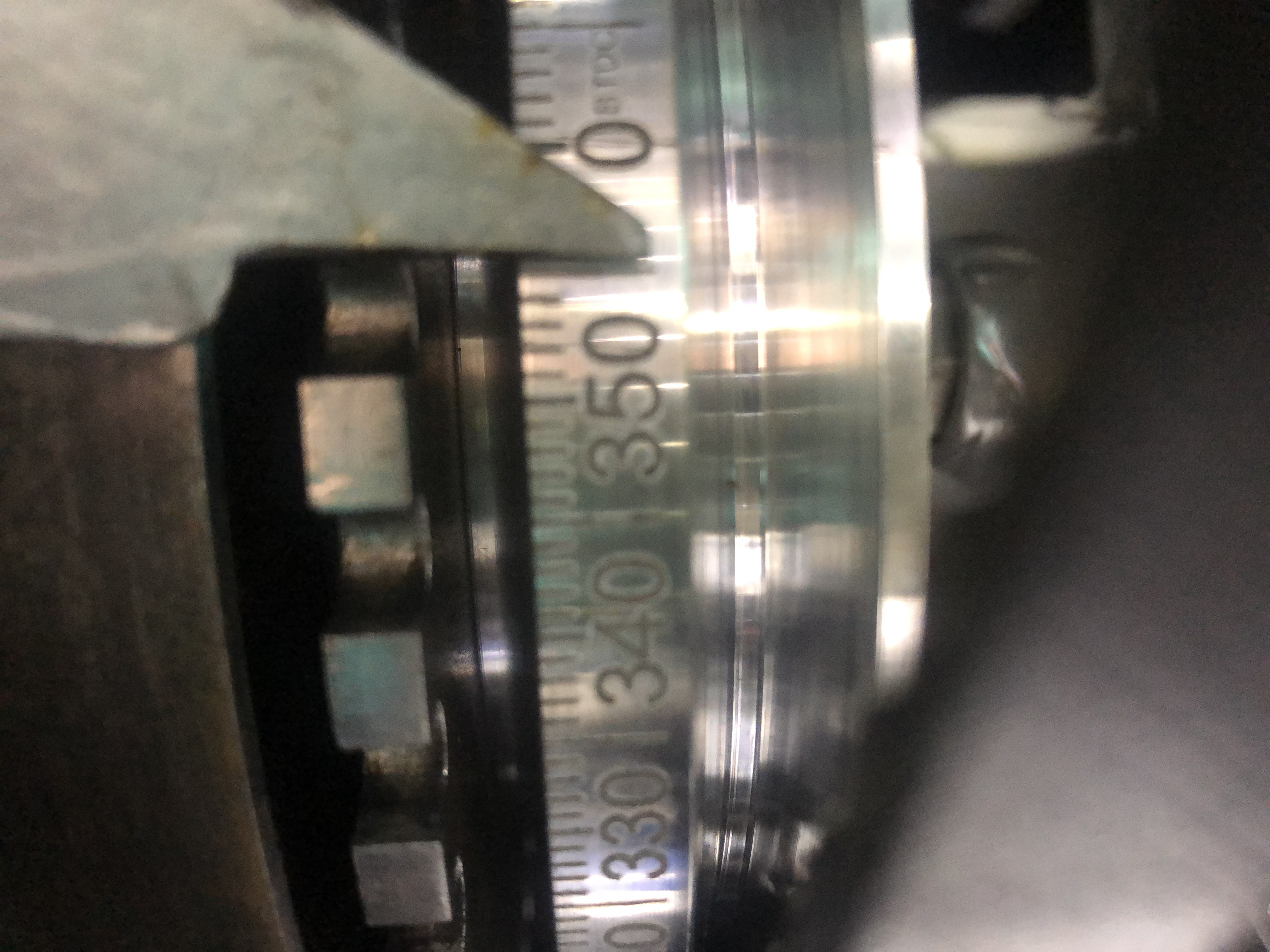

Firstly I've made up a crank pulley with degree markings on it.
Then I made up a spark plug holder for a DTI to check that TDC on my timing pointer is at true TDC
Posts: 466
Re: Camshaft: Trying to identify and check
This verified that TDC is correct on the pointer.

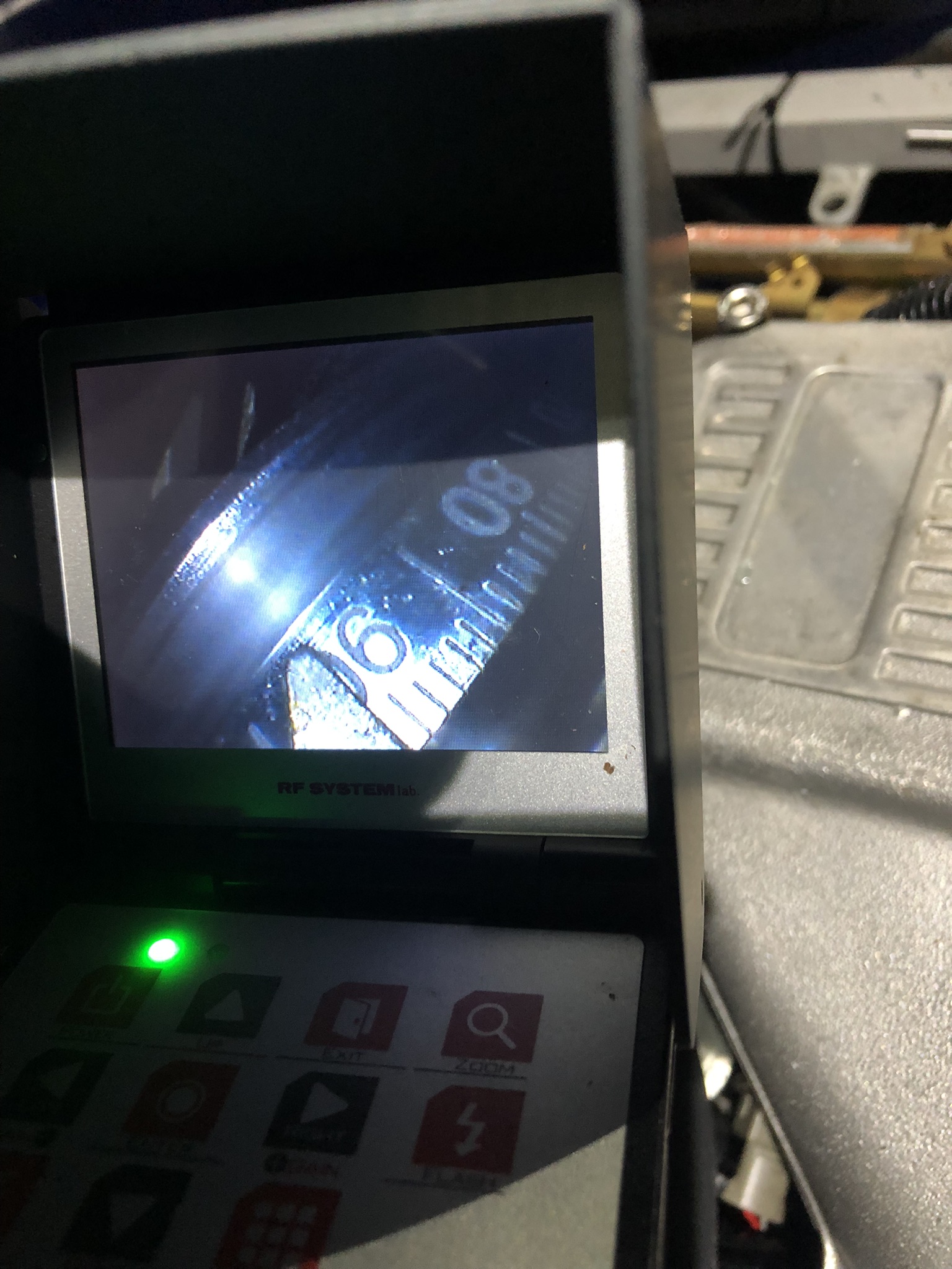

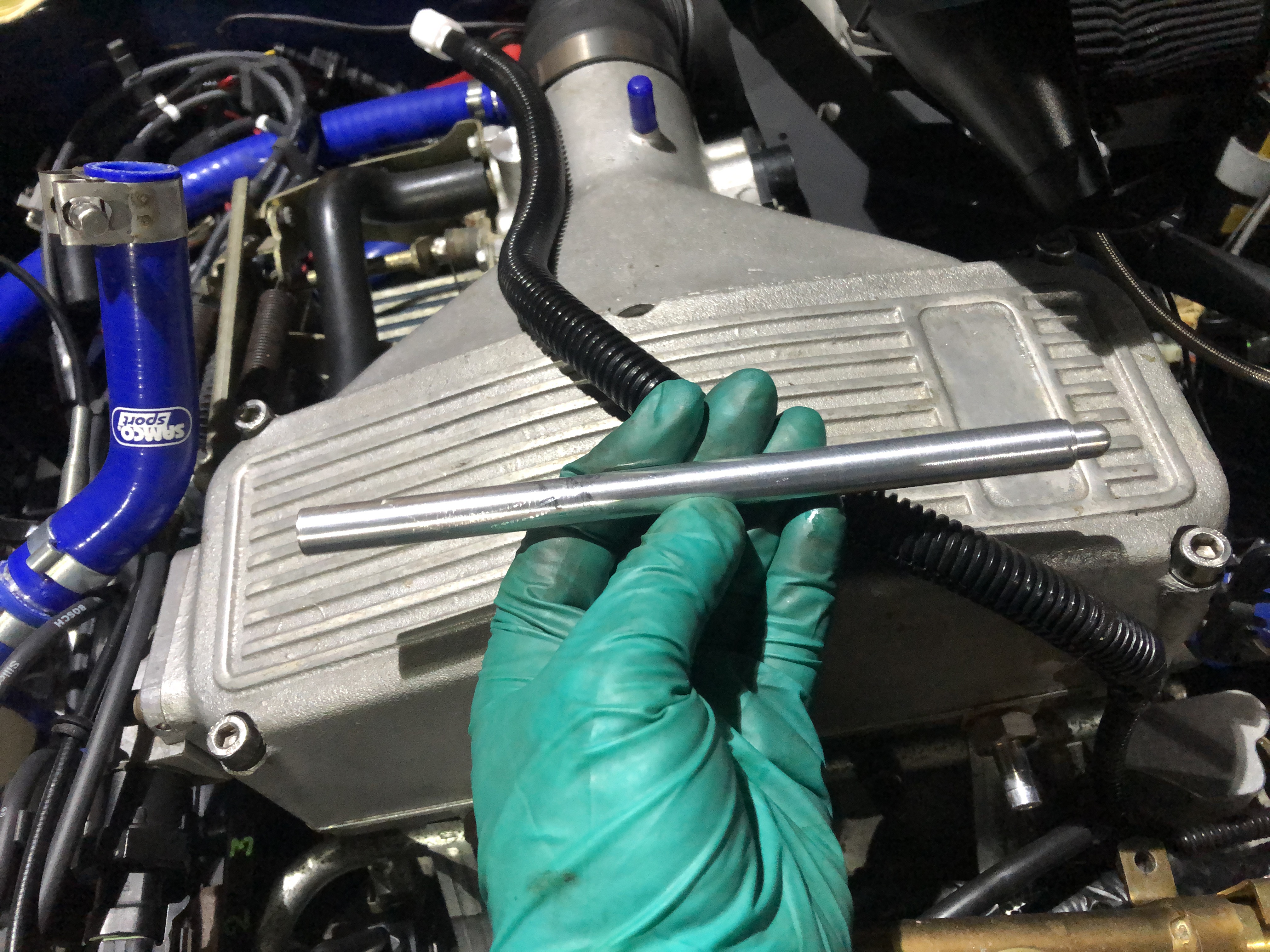

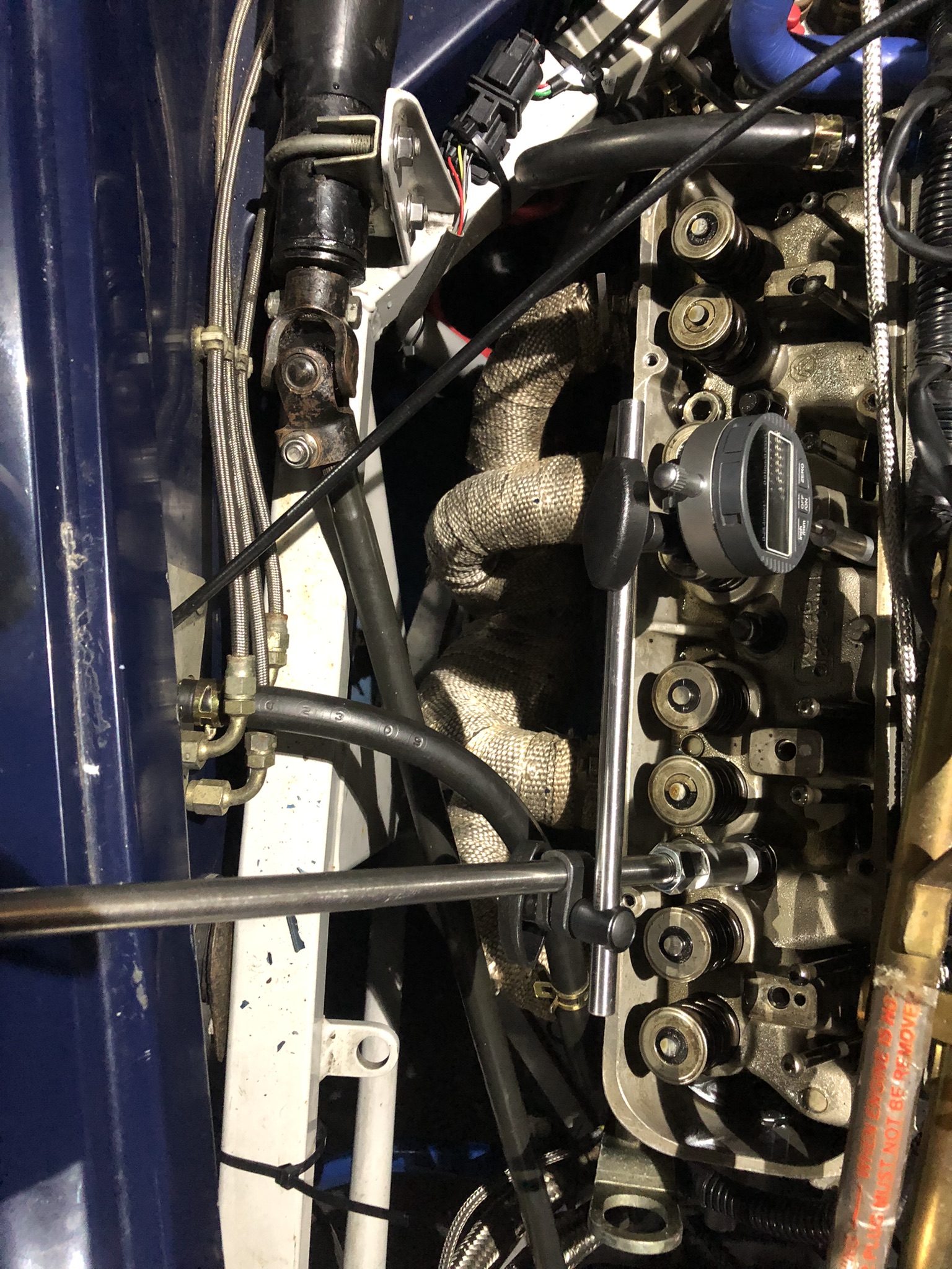

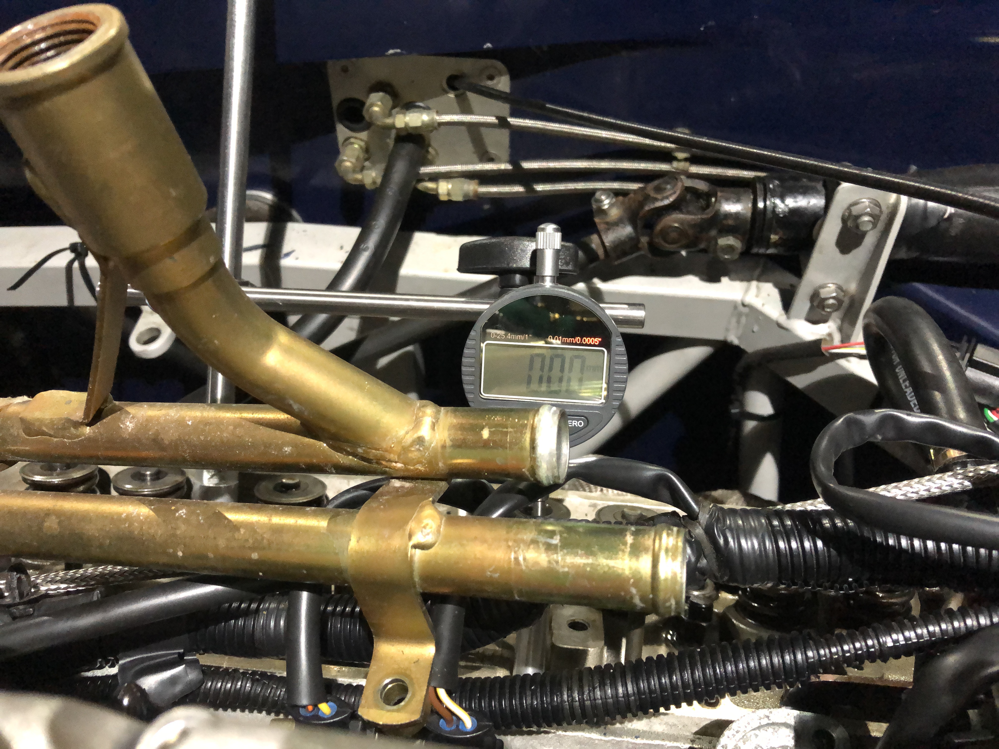

I've than created a setup to hold a DTI against a pushrod which is bearing against the lifter.
I've setup an endoscope to make it easy to see the engine position and the lifter position at the same time.
Posts: 466
So now I simply rotate the engine and read off the lift values
