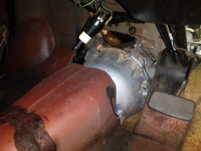

The first 'real' job I'm tackling (I have a bunch of ideas in my head for problems I'll encounter) is the physical placement of the engine. I didn't have to cut out as much of the tunnel as I expected, the v8 BW66 I'm using isn't much larger than the 4cyl BW35 that was in there - so all the modifications are under the dash (yay!). I'm no welder, so I asked a favour of a contact and he came through in style.

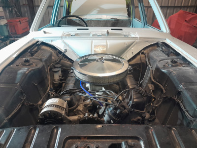

Apologies for raising the nekro thread, but I figured it was better than starting a new one. Ok, I've been busy, but it's taken a long time to get to where I am. The v8 is in and mounted to the chassis- the only modifications needed were new mounts (obviously) and widening the trans tunnel to fit the BW66 behind it. Diff is a Toyota RN20 Hilux, and to change the front stud pattern to match I've used MkIV Zephyr hubs mounted to GT Cortina discs/calipers, which will be fed by a twin circuit system, the fronts being boosted by an under dash remote servo. Everything in the engine bay is TIGHT so I've had to have some block huggers modified to pass around the steering box and made a plate to delete the manual water-pump. I'm using a Davies Craig 150EWP with a custom alloy radiator and thermo fan. So far I think the engineer should be happy (yep, I'm in OZ with the Nanny State rules). It's getting close to driveable, I can now start and run the engine in the car. My pics are on another computer so I'll post them soon.

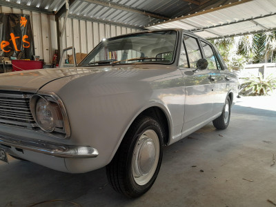

That's a nice sleeper
