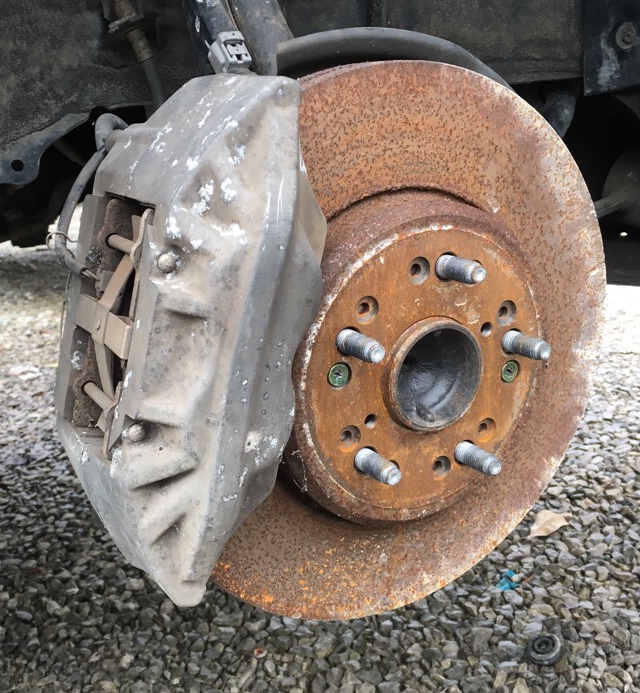

I’ve just pulled a set of 4 pot Calipers and discs off a ‘97 LS400 for £27 and am looking for a comparison to stock vitesse and jag stuff as regards piston area and unspung weight increase (of jag and Lexus stuff) over stock.
The Lexus discs are about 12.4” dia And as you might expect for the size, are very heavy around 22lb / 10kg each. The calipers though, are only 7lb / 3.1lg each (with Pads, pins, etc) and are very, very sturdy looking, yet quite compact (minimal overhang radially from the disc outer diameter) for what is quite a large caliper. Pistons are 42.8mm diameter.

I really appreciate the input, wow, 48mm, its no wonder folks find these impressive, despite the not overly significant increase in disc diameter; that's a 17% increase in pad clamp force for the same pedal effort!
I've decided the Lexus calipers, while fantastically cheap, simply don't fit very well with the mounting bosses in the shape they are in; they interfere in every way with the bosses on the SD1 hub.
I'm now going with Wilwood superlights, and using the 325mm dia x 28mm disc from the 2002-ish XK8, or the 320mm dia x 28mm from the charger/challenger/magnum as these have 5mm more inset than the jag disc, allowing more room for the caliper to squeeze into the larger part of the rim. These discs will both need the ID opening up to suit the rover hub, and either slim nuts or (as I'll likely do) simply machine the existing rover disc down in the area with the threaded mount holes, leaving a strong threaded "nut ring" that will also aid in clamping the disc to the hub with surface area.
Or, I may just jump on the wilwood 106-11862 ($56 ea) / 160-12206 ($104 ea) discs at 310mm x 28mm with the 8x7" mounting PCD that will require a custom bell. These discs are easily available and pretty cheap all said and done; only the bell is the pricey part.
