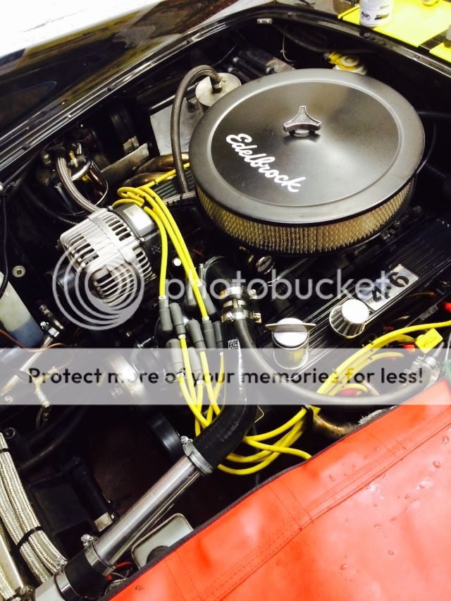

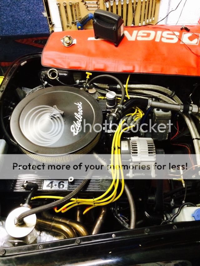

Well its finally installed. Started it yesterday, took a bit of time but it runs and has oil pressure. Only been run for about 2 minutes, so Its still lumpy and I doubt lifters are pumped up.
Will run it for 30 mins at 2500 rpm on Friday to bed cam in. Then off to the rolling road.

Just put on a geared starter, Due to tune of motor, the C/R is at 10.3:1 so the std starter just wont cut it.
